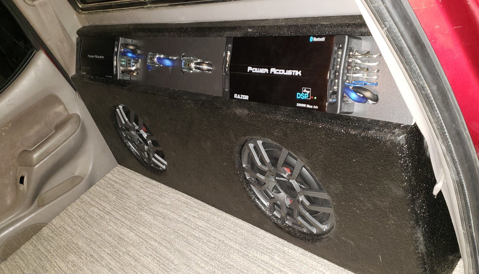

    I think I've reached a spot where I want to go all in on the sound system in the rig. I did a lot a stereo installs back in my 20s but that was 20 years ago when Zapco and HiFonics were the way to go. Kicker was pretty up there in quality too. I know a lot has changed, and I'm not real familiar with best options now days. I don't want to buy brands that used to be good, but sold their souls to WalMart and China, and are actually a waste of money :rofl:
    Not looking to break the bank here. But willing to spend a bit of coin to get good, reliable, sound.

    One of the things I think I need to improve is the head unit. Right now I'm running Kenwood Head Unit (a lower model) with all Power Acoustik speakers and amps. (I know, I know) It was just to get something, for the last few years, for cheap... while I was going in different directions on the truck (re-gears, new axle, long travel, etc).
    Now I'm tired of not being able to get the sound right. I've been adjusting this stuff for 4 years and can never get it where I like it. 100% because it's all cheap stuff... I totally get that.

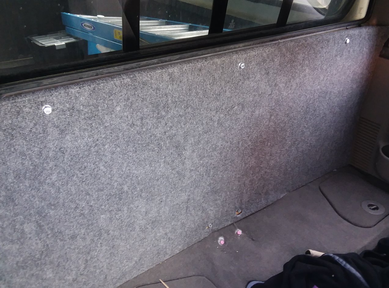

    I don't have back seats either - replaced with a plywood sheet

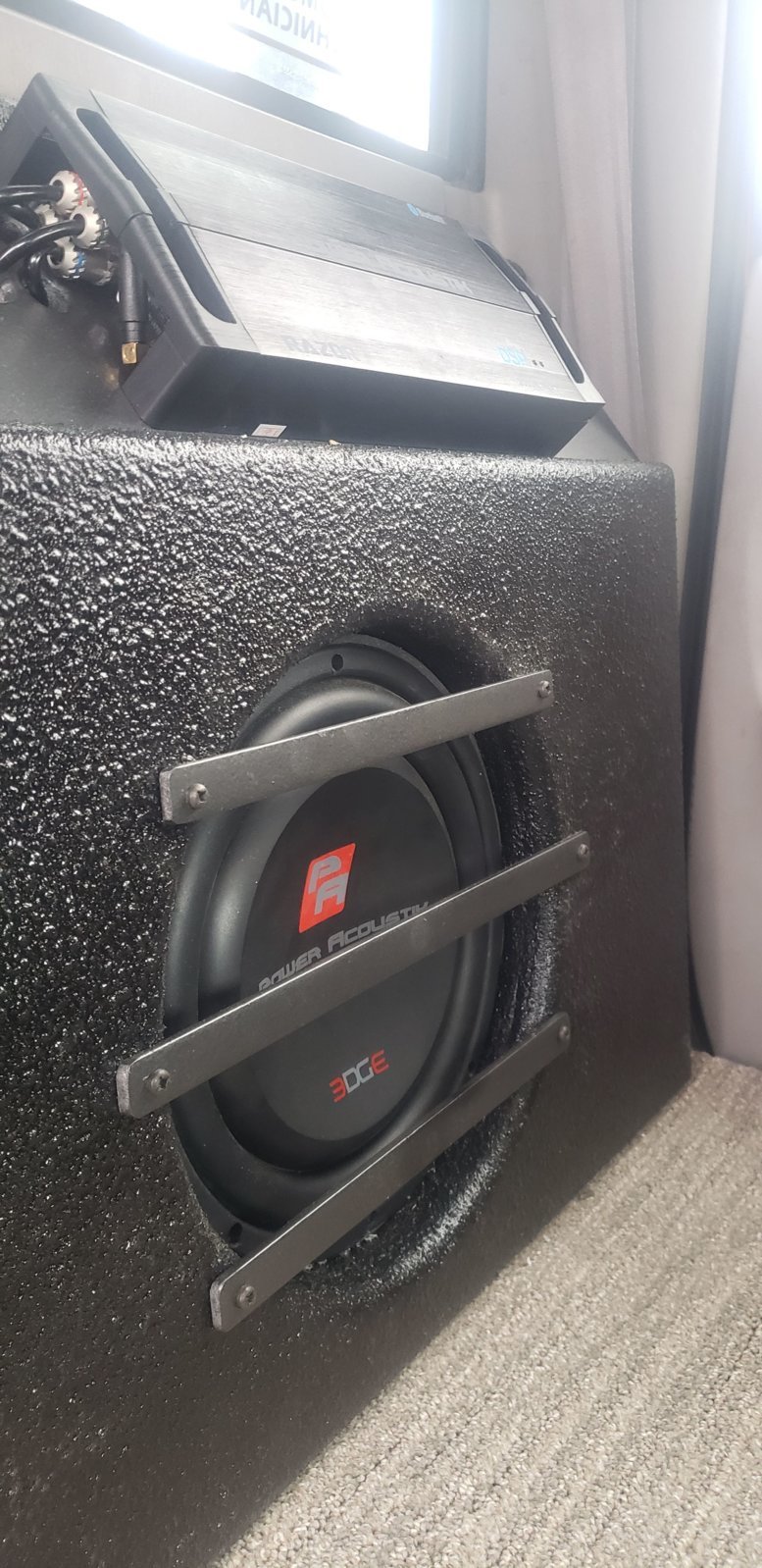

    I ended up losing those speaker grates and making my own.
    The speakers were traveling enough to hit the original grates.

    Loving how creative you got with the install! I can't wait to see where you go with the next version!
