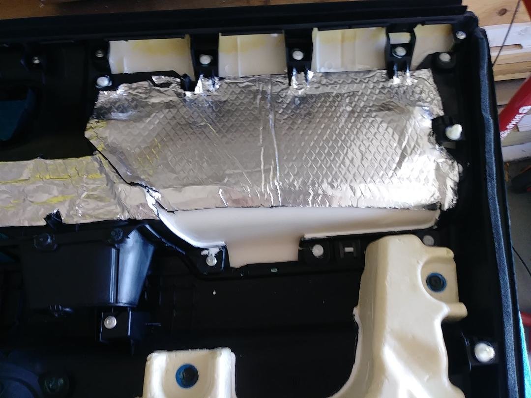

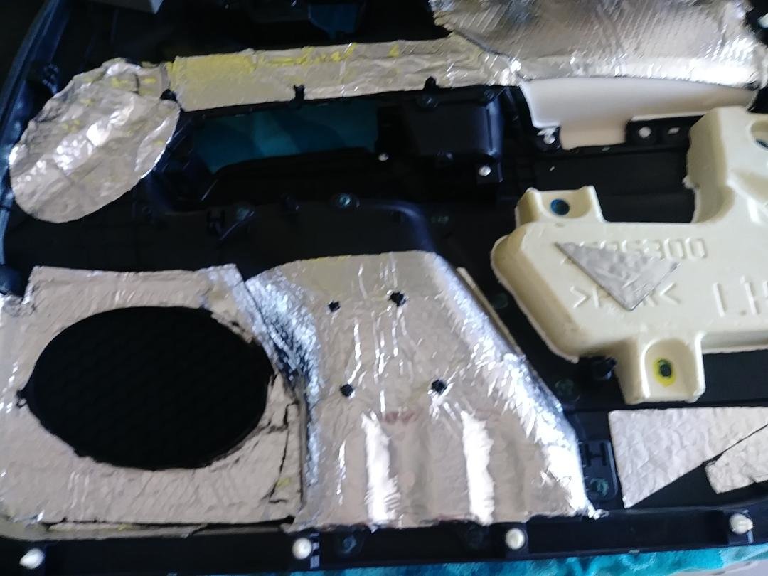

    i also have stock Entunes HU and did the tweeters and front door speakers.
    when doing the tweeters have the new ones within arms reach when you remove the very short wire from the old ones. hold on to the wire and grab the new one and clip it on. if you let go of the wire it can fall down in the dash and you will have to fish it out, the windshield is in the way.
    also my issue was the front door panels vibrated when i played EDM loud so i had to take the panels off and install sound deading.
    the bottom pic is the area by your shoulder driver side. that insert is poorly attached and can vibrate, you can see where i added white caulk also. i also sound deadend the door area.
    issue solved!
