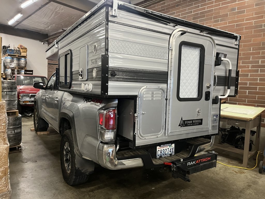

    Well, I got the Alcans installed. They did an amazing job getting the load correct. I told them my scale weight, 0” lift with factory rake when loaded. They sure nailed it!
    Haven’t had the opportunity to drive it yet but I’ll report back.

    I was also worried about the clearance between the sumos and the frame, alas, should still be very compliant. Still haven’t pulled the air line from the air bags, good riddens!
