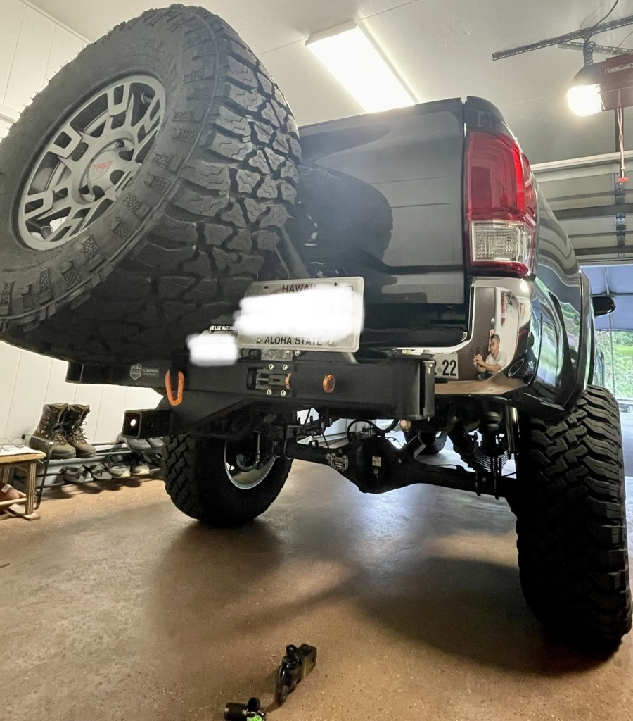

    Interesting, so folks actually run no spare tire?

    Generally if you put a crossbar for the hangers it impedes where the spare goes so you have to relocate it in order to run one. My plan was to build a crossbar that wraps around the spare but I've not gotten to that yet (and probably won't). There should be a way, but having to rely on others with the tooling to do it and finding the time is getting in the way.

    According to GlueTread, a spare is a waste if you have their product! I personally wouldn't feel comfortable not having a spare.

    I briefly looked into this. A crossbar under the spare hangs down too low for offroad use. (That, and it would make accessing the spare tire more of a PITA.)
    Also, there’s no room to attach any sort of bracket behind the driver side hanger. The spare tire is not centered under the truck, and butts right up against the driver side shackle hanger.
    I also looked into whether a crosstube or gusset might wrap around behind the spare, and even be incorporated into the rear bumper, but again, there’s not much room to work with, and at that point you might have diminishing returns. On my truck, the spare sits right up against the rear bumper: 33” spare, BAMF rear bumper. In fact, I have to deflate my (full size, 33”) spare and ratchet strap it to the rear bumper to keep it from rubbing against the rear differential when the suspension is fully compressed.
    Also, in regard to structurally unifying the rear bumper and the hangers, a rear end collision might be capable of doing a lot more damage to the frame.
    (All that said, you have me wanting to take another look, just to be sure. :) ).

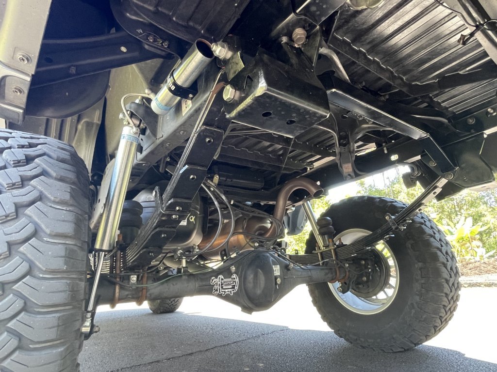

    Do it

    Clean. What shocks are those?

    is that the regular cross tube or is that one fabbed?

    Bilstein 5160s
    regular tube offered by archive. Been a few years since I’ve done it so I’m not sure if he’s offering the same still? I’d have to check
