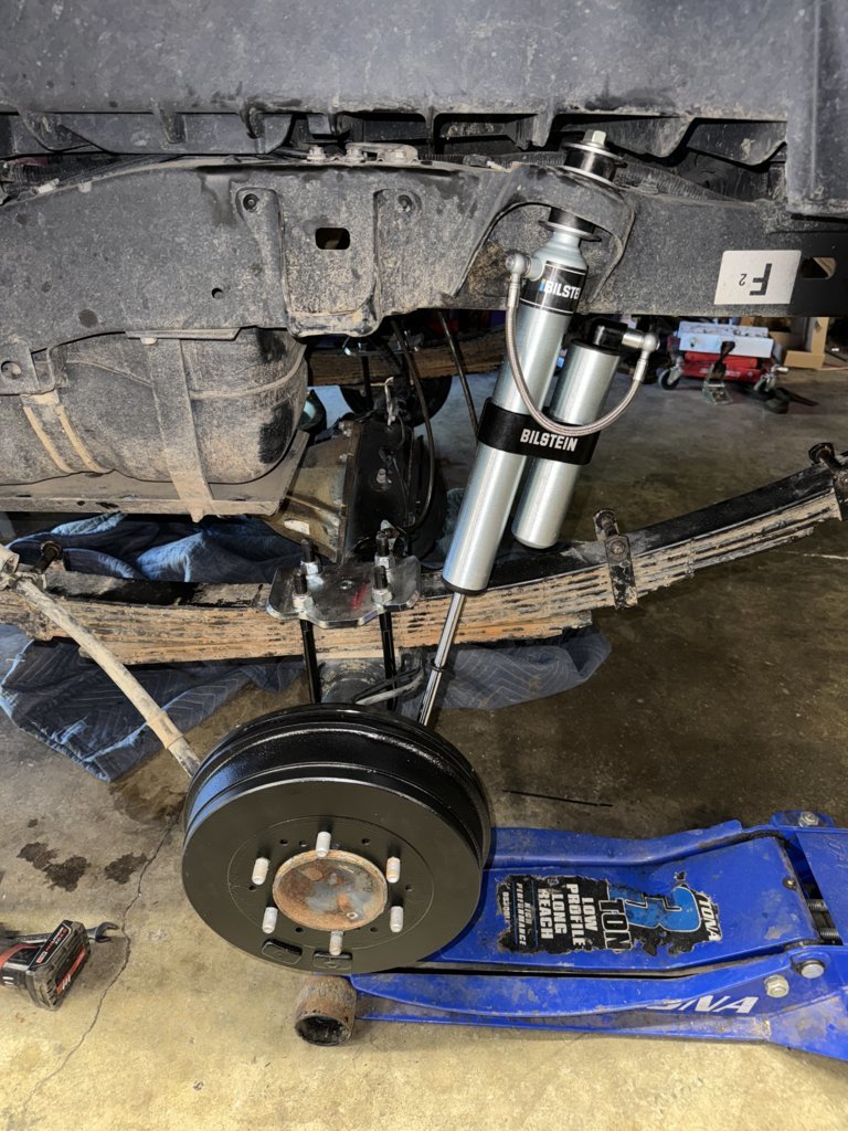

    I am running 5160's (for a Tundra, modified for a Tacoma) that came with piggyback reservoir mounts. I found that the shocks would tend to rotate, so that the leaf springs would bang into the reservoirs (mostly on the driver side). I ended up replacing the piggyback mounts for frame mounts.
    I picked the Tundra shocks for a slightly longer stroke, but also because Tundras weigh 5,500 to 6,000 lbs curb weight, so the shocks are valved more appropriately for the fact that I have a camper and interior buildout in the bed. I switched from 5150's made for a Tacoma, and the improvement in ride quality was impressive.

    Are they eye to eye shocks that need an adapter or are they the same stem mount as the tacoma ones?

    they swung around cause the 5160’s are remote, but have the option to be piggyback mounted.
    The falcons pictured are solidly piggyback
    I too run longer and tundra 5160s with stud conversion

    @alwaysHI There doesn’t appear to be anything special about the Falcons that would immobilize the bodies from rotating in the stem mount. The rotation doesn’t occur at the piggyback bracket. It occurs at the stem mount. The bodies rotate freely around the shock shaft.
    That said, it looks like the Falcon reservoirs are shorter than the Bilstein reservoirs, so maybe the leaf springs don’t flex high enough to bang into them. It also looks like the Falcon reservoirs might be high enough to rotate to rest against the frame, which might keep them out of harm’s way.

    Been a minute since I’ve read it. But wasn’t the hammer hangers supposed to keep the leaf packs in actual alignment vs factory?
    Maybe that’s why I never run into that issue either..
    My 5160’s came with Bilsteins “piggyback” mounts (pretty sure I have them still in storage), I’ve never used them tho. And like you said, the Bilstein resi’s are rather large

    I had the resi interference problem with Hammer Hangers.
    I just looked back through my old pics and my resi’s were significantly lower than the Falcon resi’s.

    that’s a good pic, and info for anyone in the future.
    Look how massive those things are lol

    I think I moved them up a bit after taking that pic, but obviously it would be impossible to mount them with the bottoms of the Bilsteins being as high as the Falcons.
    You can see in the pic how easily the leaf spring retainer bracket (Deavers) could contact the resi body upon compression, if the shocks rotate even a little bit.
