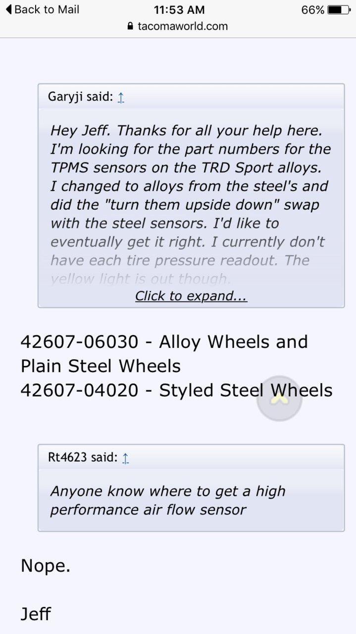

    As has been said, new TPMS sensors and lug nuts. Not sure about long or short, but the alloy wheels have to have a flat washer on the lug nut. The steel nuts are acorn shaped. Here are the TPMS sensor part numbers. Don't cheap out with after market sensors. Good chance you will have problems. The new sensors will have to be programmed into the computer. Make sure to write down the codes on each sensor BEFORE you install them.
