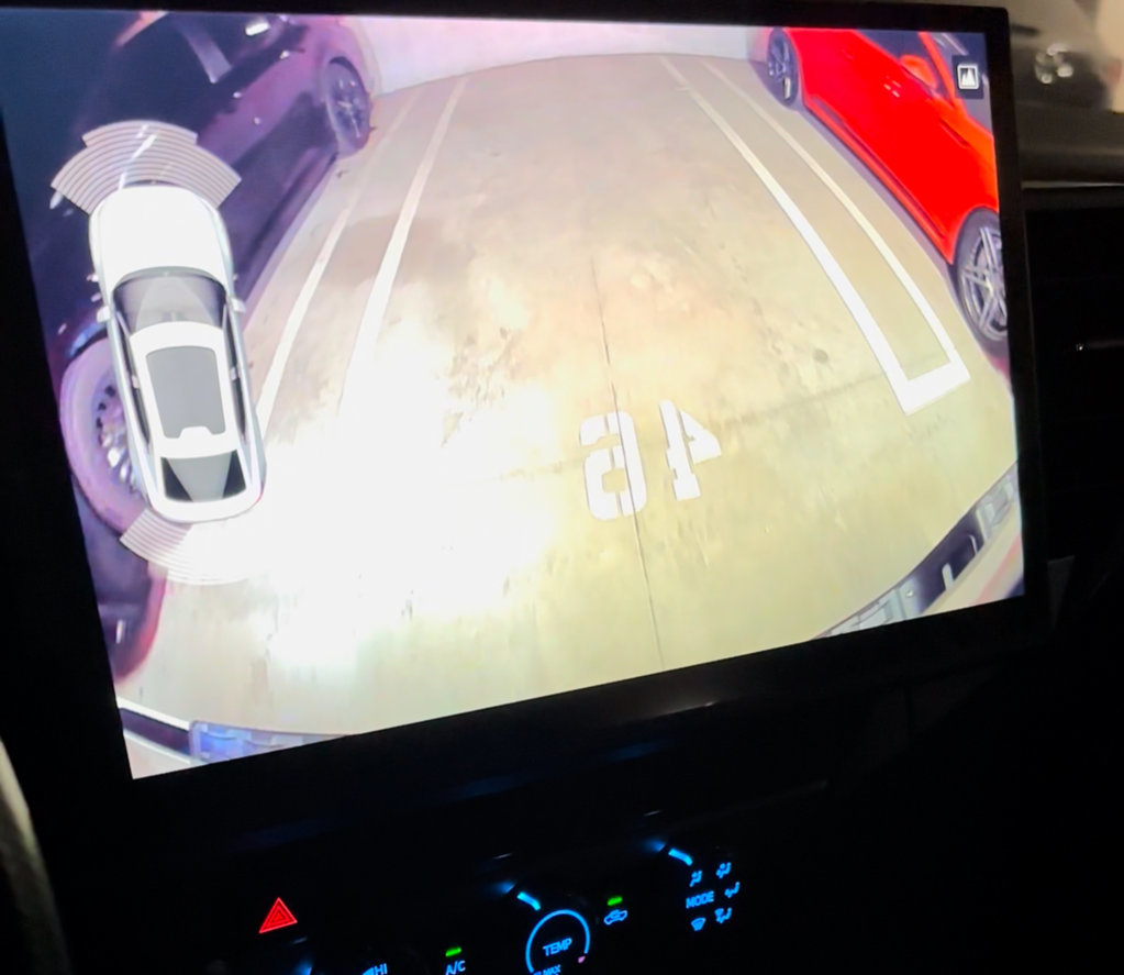

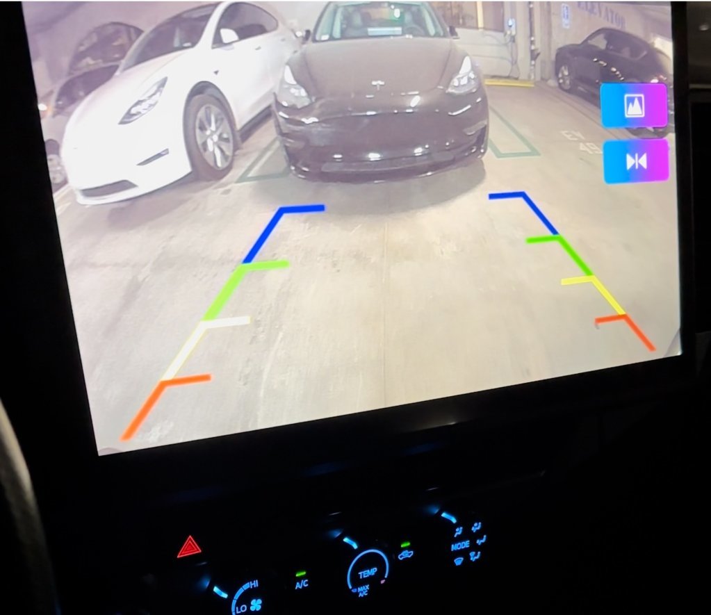

    Haven’t seen anyone else find something quality yet.
    here’s my custom plug and play 1080p 170 degree rear view camera. Still working to get it perfect yet this is about 90% completed.
    this is on an aftermarket headunit and I’ve already upgraded the front camera. All through alibaba parts so not breaking any banks.
    esizzle777 and 92se-r like this.

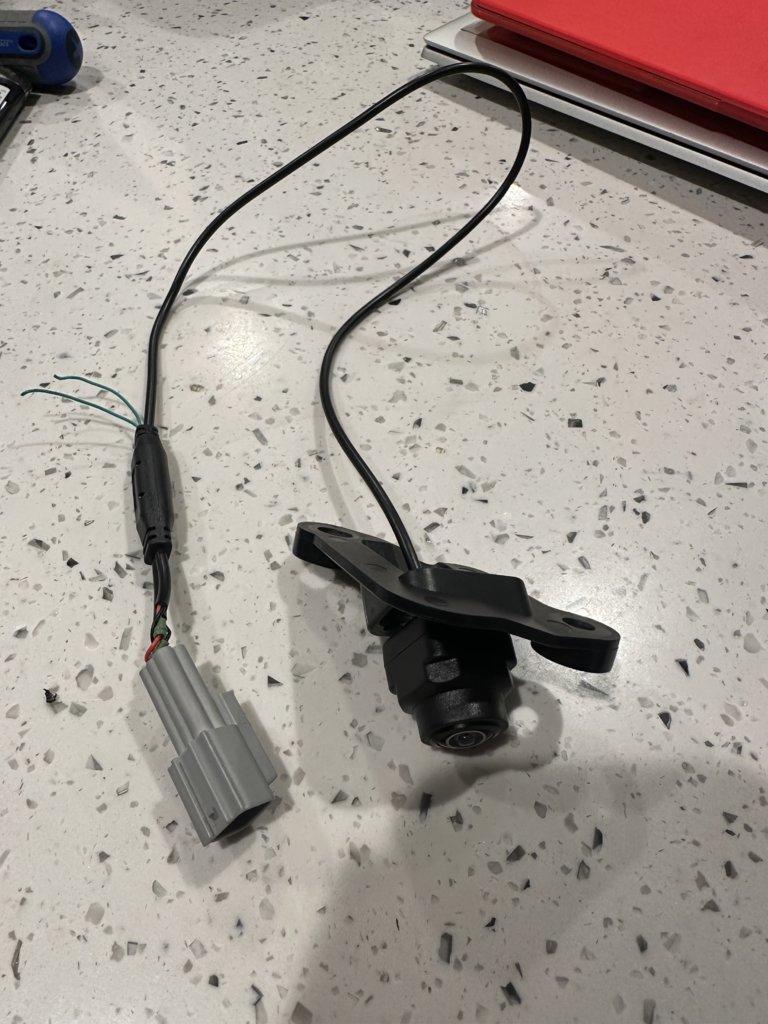

    it works. Yet woking to align it and perfect it. Trying to get someone to 3d print the mount to make it 100% I’ll upload photos later this week of before and after.
    here’s the front I’ve worked so far. yet this is easier as it’s stand alone rather than mounted on factory bracket
    give me some time and I’ll update the post. Trying to make them as cheap and as plug and play as possible.

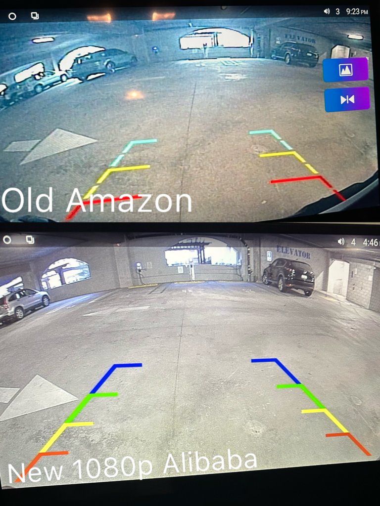

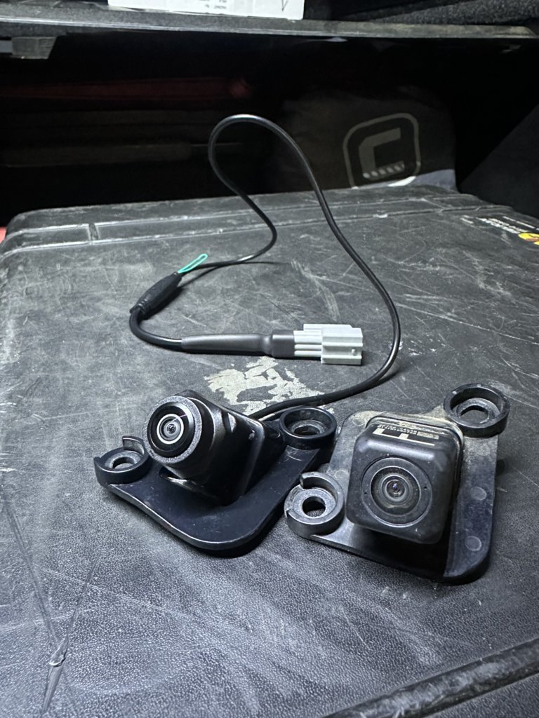

    Ended up getting it plug and play. Yet need to work on mounting.
    Only thing that didn’t happen was the guidance lines and could be do to how it’s wired? Yet cutting the green wire or not made no difference.
    this is also a 170 wide angle. So tucked inside the tailgate handle it sees too wide and shows up.
