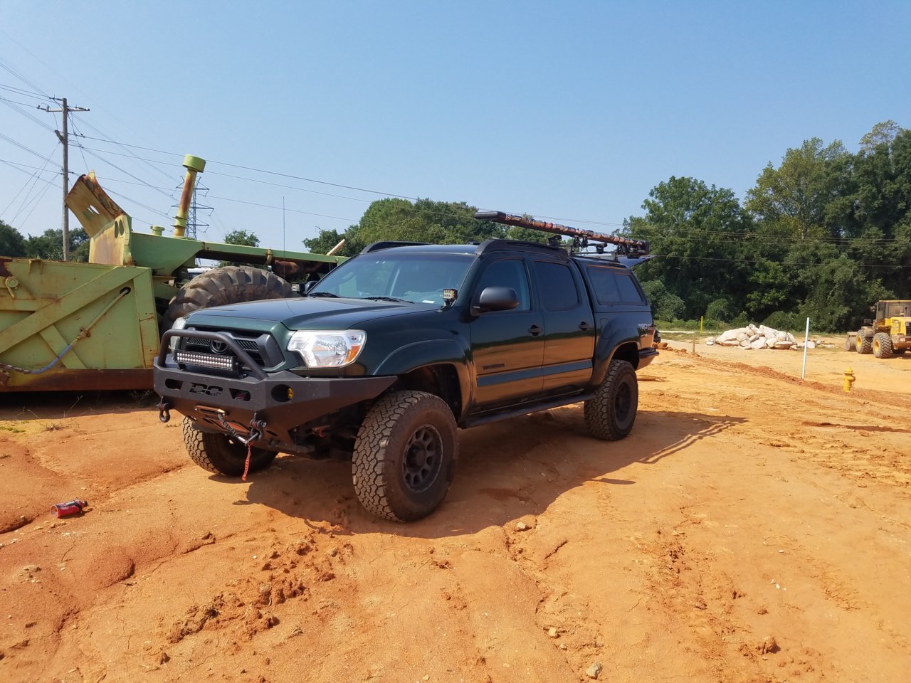

    I'm at a crossroads with my truck. It's not a comfortable ride but all due to mods I decided to install. I've got plate bumpers, sliders, full skids, and installed the OME 886 springs with firm nitrochargers. Also Dakar HD pack and superbumps. Riding on Pro Comp 7032 with General Grabber ATX in 285/75/16, load range E. I'm pretty unhappy with my ride quality and feel like my daily commute is beating me to death on the terrible roads in SC.
    I've gotten close to pulling off my front bumper and skids so I can swap back to a softer suspension but I hate losing the protection and winch. Fwiw, I rarely offroad and built the truck with future plans to take it on expedition style trips since camping and fishing are my favorite pastimes, of course that hasn't happened yet since I work more than I care to so most of my offroad now is on forest service roads and undeveloped job sites. I dont have the funds to do so right now but I'm thinking about replacing the suspension with kings or going up a wheel size to get some Load C tires in 285/70/17. My other option is ditching all the steel up front and going to a milder suspension, potentially even going down in tire size. Love how the truck looks and its capable, but at this stage I can't afford a daily driver or dropping more money on it. Thoughts? I doubt I'm the first to mod and later wish I'd left it alone.

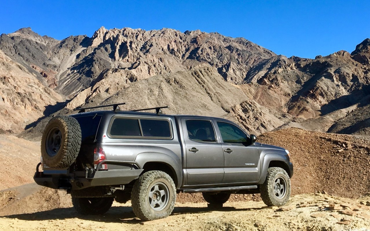

    I have the old Dakar with the 3rd leaf removed. The ride is nice...borderline soft. I'm going to add the 3rd leaf back to see what it rides like. This pic is loaded up with 2 spares (265/75/16 c rated), a hi-lift and 50lbs of recovery gear, and another 150ish lbs of camping gear. Running Fox 2.0 with remote reservoirs in the rear which helps too.

    Good looking rig, let me know your thoughts once you add the leaf back in. Suspension upgrade definitely something on my list.
