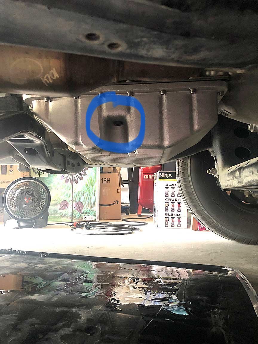

    @ARB1977 - what are you using on the ground to catch fluids ?

    @ARB1977 That pan looks dope!! So what are their claims with it? What's the benefits of running it?

    Thanks for the compliment.
    It's just angle and flat aluminum stock I painted black.

    Interesting. Im sure it helps but i have always liked how tucked the stock pan is up under the truck... damn thing already has 11qts in it stock.

    Yes Allen bolts. Did a retorque a few days later. No leaks to date. About 10K miles since the change.

    That’s total capacity including cooler and torque converter. Not what’s in the pan. The pan holds about 4 qrts. This pan is about 7.

    Correct. but its all circulating.

    More fluid for sure. Cooling I haven’t monitored it yet. I got for 150.00 when they where looking for test vehicles. As long as I have them my feed back. The drain plug has a magnet so no magnets in pan.

    I would assume so. There’s no baffles.

    How do you check fluid levels on that transmission pan?

    id imagine the same way you do on the stock one via the check bolt (which is probably spaced the same distance away from the valve body)

    There’s a check bolt your remove like the stock pan. The tube inside the pan is in the same location as the factory. The drain plug is on the other side.
