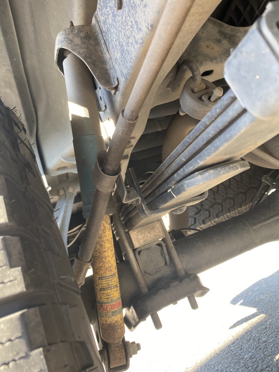

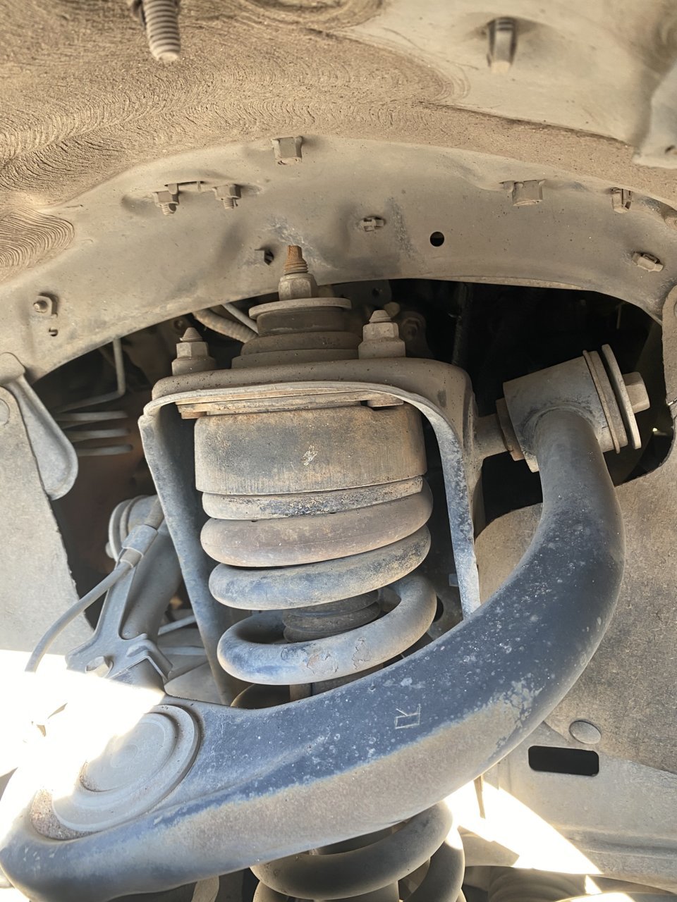

    Can you see how thick the front spacer is or take a pic of it that’d be helpful.

  10. Apr 9, 2020 at 9:50 AM
    MattCowsmasher
    MattCowsmasher ( -_・)ᡕᠵ᠊ᡃ່࡚ࠢ࠘⸝່ࠡࠣ᠊߯᠆ࠣ࠘ᡁࠣ࠘᠊᠊ࠢ࠘
    Apr 7, 2017
    #215629
    48,695
    Temple, Tx
    O3 Rubicon wrangler
    Looks like a 2in front 1 in rear. You could go with a old man emu kit and have a much better riding/performing setup. Check out headstrong off-road they are very knowledgeable and great customer service.

    If you don't off road much, a spacer isn't really that bad of an option. I'll get flamed for that, but I don't care.
    EDIT: This statement I made earlier, is incorrect. (The problem with your current spacer in the front is that it's under the top hat of the strut, compressing your spring. That's a good portion of why your ride is so stiff. If you removed that spacer and went with a spacer that mounted to the top of the strut hat, you're ride would be noticeably better.)
    I've been running a spacer lift for a few years now with no problems. My front spacers are outside of the struts though. It is also a less expensive option.

    I really wish that myth of "compressing the spring" would die. It's not compressing the spring. If it were, there would be no lift. All that spacer does is lower the top resting point of the spring, pushing the lower control arm down, thus raising the front of the truck. Don't believe me? Do a before/after measurement of the spring itself on a spacer lift.
    What it *does* do is extend the shock, which is why a top mount is preferred.

    Isn't the up travel of the strut limited by the stroke of the shock absorber? I would guess, although I've never verified, that if you put a two inch spacer inside the strut assembly, it wouldn't be two inches longer when it's still sitting on the garage floor. That's why you need a compressor to get the stock assembly apart. The strut assembly overall length is limited by the full extension of the shock. I would bet its still the same length.
    IF that's the case, yes, the spring is compressed.

    Explain how a spacer lift works by "compressing" the spring. The front end would go down if that were the case. As stated, it does lengthen the shock somewhat in OP's configuration, which is why the top spacer is preferred. But this myth of a spacer compressing the spring is bogus. Think about the geometry of what's taking place.

    You have two mounting points for the front strut assembly: Point A, which is the top mount, shock tower, whatever you want to call it. And you have Point B, which is on the lower control arm. Point A cannot move relative to the rest of the body - it's fixed in the bodywork. So the only way to raise the truck is to make the distance between Point A and Point B longer, which we do by lowering Point B, the lower control arm. (I'm excluding drop spindles here)
    We do this by longer springs, like OME and others. Or we do it by "lengthening" the stock spring package by installing a spacer. Those are the only ways to lengthen the distance between A and B. If, as you say, the spacer "compresses" the spring, then what you are saying is that the spacer is shortening the distance between A and B, thus lowering the truck. It doesn't make sense. A spacer lengthens A to B by pushing the whole package down, lowering the lower control arm, thus raising the whole front of the truck. That's also why we should use extended length shocks like the 5100's than can handle the extended length of the whole "package." I hope this makes sense.
