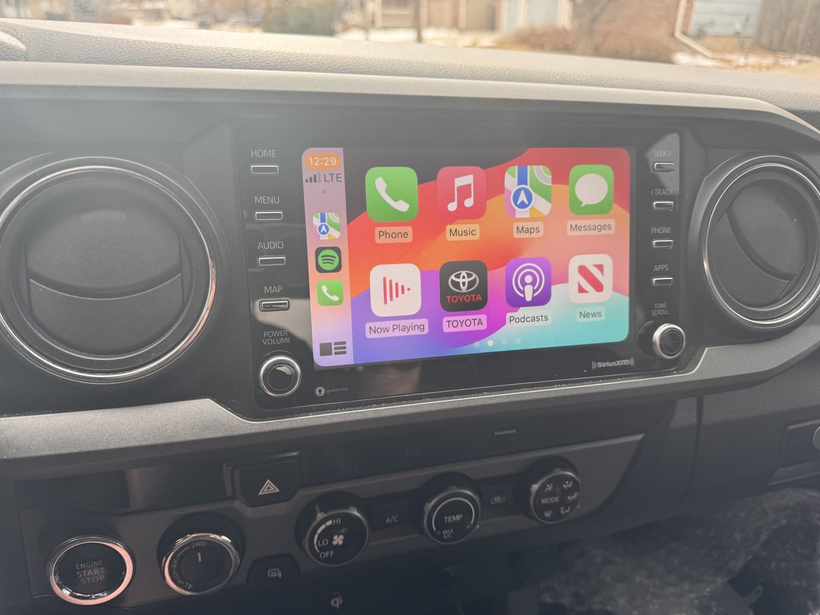

Upgrade to CarPlay!
Discussion in '3rd Gen. Tacomas (2016-2023)' started by Sandman56, Feb 7, 2024.
  1. Feb 7, 2024 at 1:21 PM
    Sandman56
    Sandman56 [OP] New Member
    Feb 2, 2024
    #443047
    DJ
    Thornton CO
    2016 Tacoma TRD Sport
    2020 3.0 Entune system installed
    Special Thanks to @Ran-TRD for the great deal and perfect transaction on this 3.0 I just installed in my 2016!

    Is that just a direct swap with a newer head unit?

    Yep, just order the ones for a RAV4.

    Part # and cost please? Also, did this require any additional harnesses or wiring or is it plug and play to the 2.0 headunits?

    Leveled with Bilstein 5100 shocks, Kumho AT52 265/75 tires, Redline hood struts, R4T tailgate lock, Matt Gecko LED strips in bed and under hood, WeatherTech hood guard, OEM bed mat, Husky floor mats, Carhart seat covers, Grille replacement with Toyota letters, Sony AX6000 replacement head unit, OTT lite/mild tune, and an occasional splash of fuel additive.
    Installed new Sony head unit Apx6000 purchased from Trail Grid Pro for my 2017 Tacoma a few months ago, one of best upgrades I’ve made. It’s a simple plug and play and allows wireless connection to iPhone using CarPlay. Maps and weather application overlay shows weather as I drive. It’s snowing today, awsome. Another option to consider.

    Sorry was referring to the meaty knobs. They are off a rav4 and fit the entune 3.0 (pictured from original poster)

    How do you know what version of Entune your truck has and therefore, what are the options for swapping ?

    Entune 3.0 started coming in tacomas 2020+ seeing as yours is a 2019 Sport you have Entune 2.0. All you need to swap is a Entune 3.0 headunit & a harness because the connections vary from headunits
