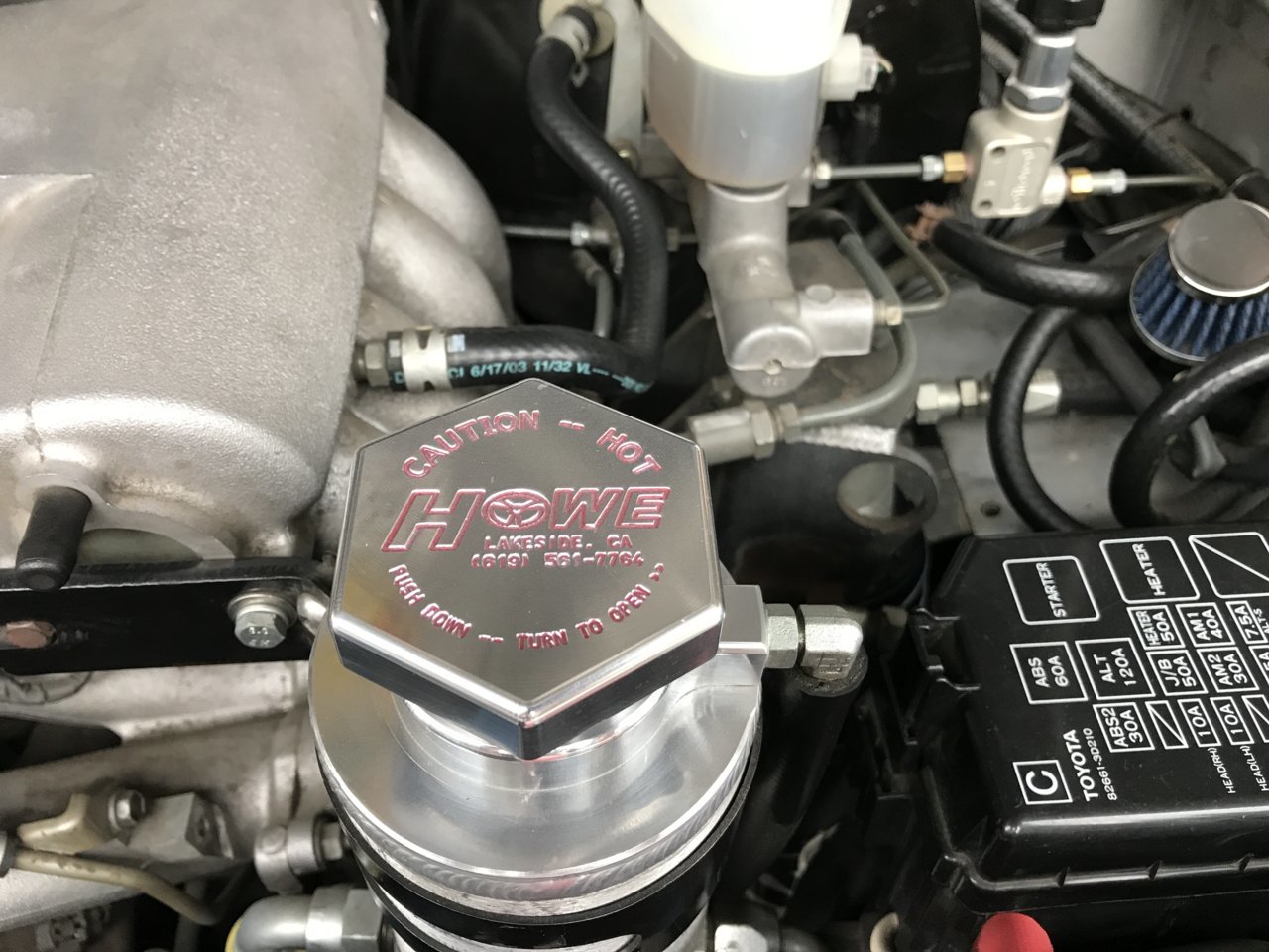

    When I installed my rear Diamond axle, I removed any/ all parts related to ABS and never had an issue. My truck is an '03 though.
    When it came to the LSPV, I installed a Wilwood unit close to the MC. You can see it in the upper RT corner.
    I hope this helps you.

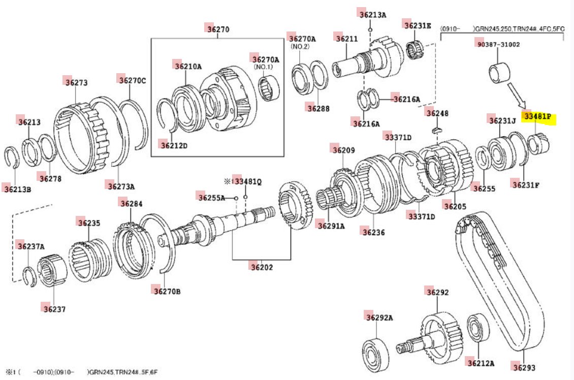

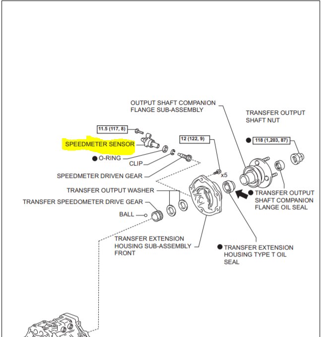

    You will need to acquire the following:
    VSS connector 9098011143
    VSS O-ring 9671124030
    VSS itself 8318112020
    Worm gear (if t-case is not equipped with it) 3348135200
    1st, if your transfer case does not have the worm gear on the output shaft, you'll need to replace the spacer with the worm gear.

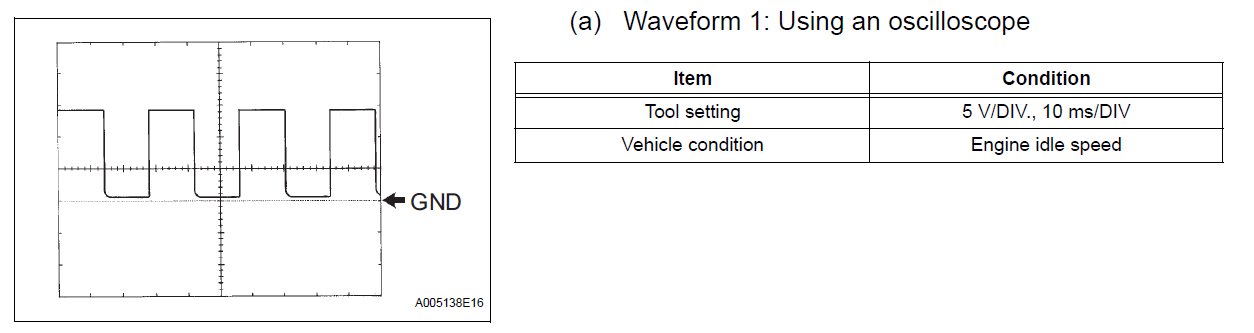

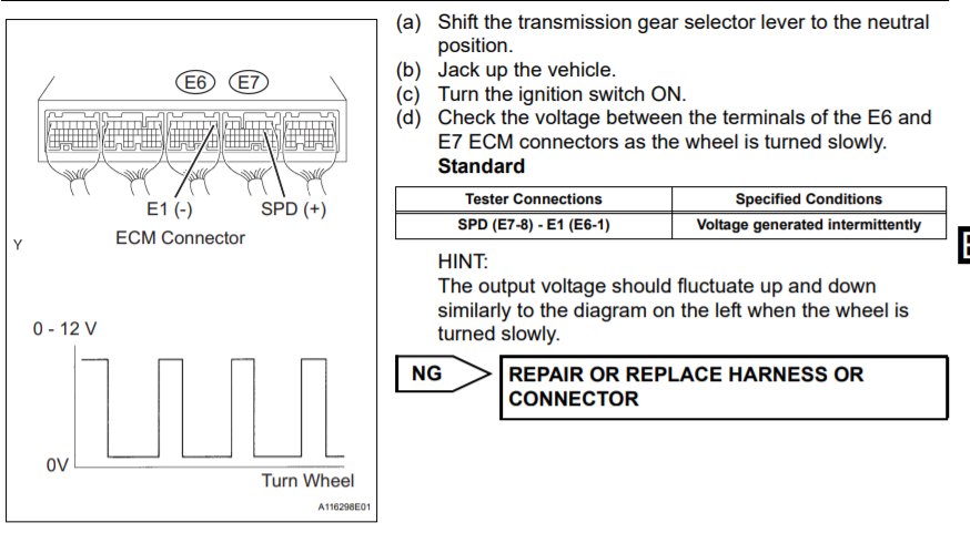

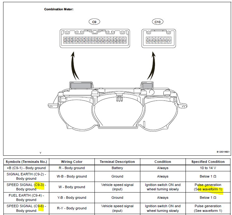

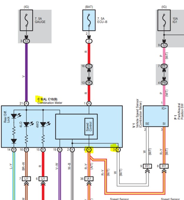

    Run 3 wires to new connector V1, one from ignition switched +12V power, and two others which will be signal wires going back to the instrument cluster connector C9 behind the drivers dash area.
    Pin 2 from VSS to Pin 3 of instrument cluster
    Pin 3 from VSS to Pin 6 of instrument cluster

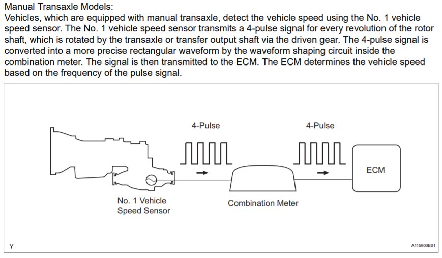

    It should be noted that once the signal is generated from the combination meter, that signal is then sent to the ECM. Whether from an automatic or from a manual, that signal is the same once it's produced by the combination meter and sent to input to the downstream ECM.
    I have also read reports of changing the teeth on the sensor assembly to get the correct speed if you have regeared, I haven't looked much into that but a few other people posted before on here with some P/Ns of different pinion teeth count for the gear speed sensor if that's something that interests you. Additionally, your instrument cluster may or may not have a wire coming out of pin 3 for the signal, you may have to procure additional terminal and wire as such.
