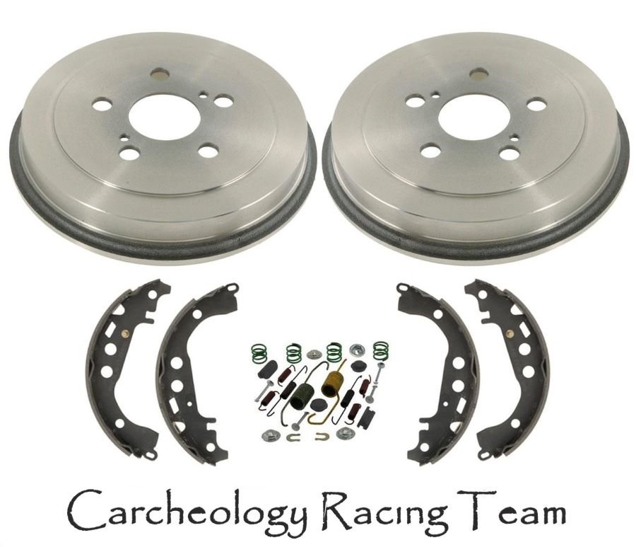

    Oh boy, OP sure triggered a lot of people with the word “upgrade” in the title.

    The only upgrade worth doing is the Mike Sweers High Performance Front Brake Kit
