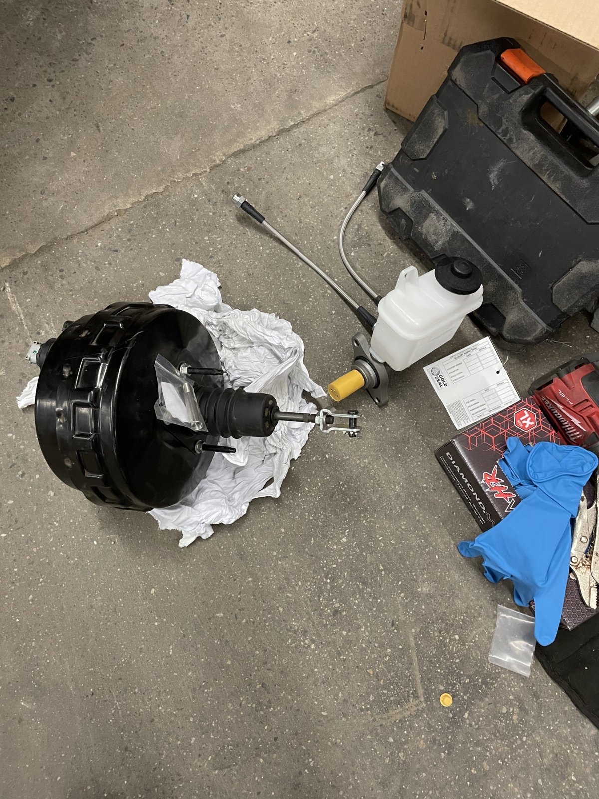

    I installed this in my truck yesterday, it’s the 2nd taco I’ve had and did it on the last one too… if your brakes are fine, cool, not all of us have the same truck or needsIMG_1767.jpg

    Glad yours are up to the task, cheaper that way, but I tried lots between 2 tacos.. 2010+ 4Runner calipers and slotted rotors with the tundra booster/ master swap is where I ended up. Finally I have brakes that feel up to the task. High, firm pedal with great stopping power.
