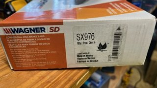

    I swapped pads to Wagners Severe Duty pads. Semi metallic so there’s a bit more dust but these thing grab very well when it’s cold. Don’t need a lot of time to get heat in them. Fade has decreased significantly.
    Friend of mine is head of maintenance for major city police department and recommended these. They use these exclusively on their patrol cars which see more braking in a week than I do in a month. Probably more in a day.
    Especially impressed with them in less than ideal conditions ie mud water snow etc. Did quite well in the dust in Baja running the west coast of Mexico. That shit is no joke.

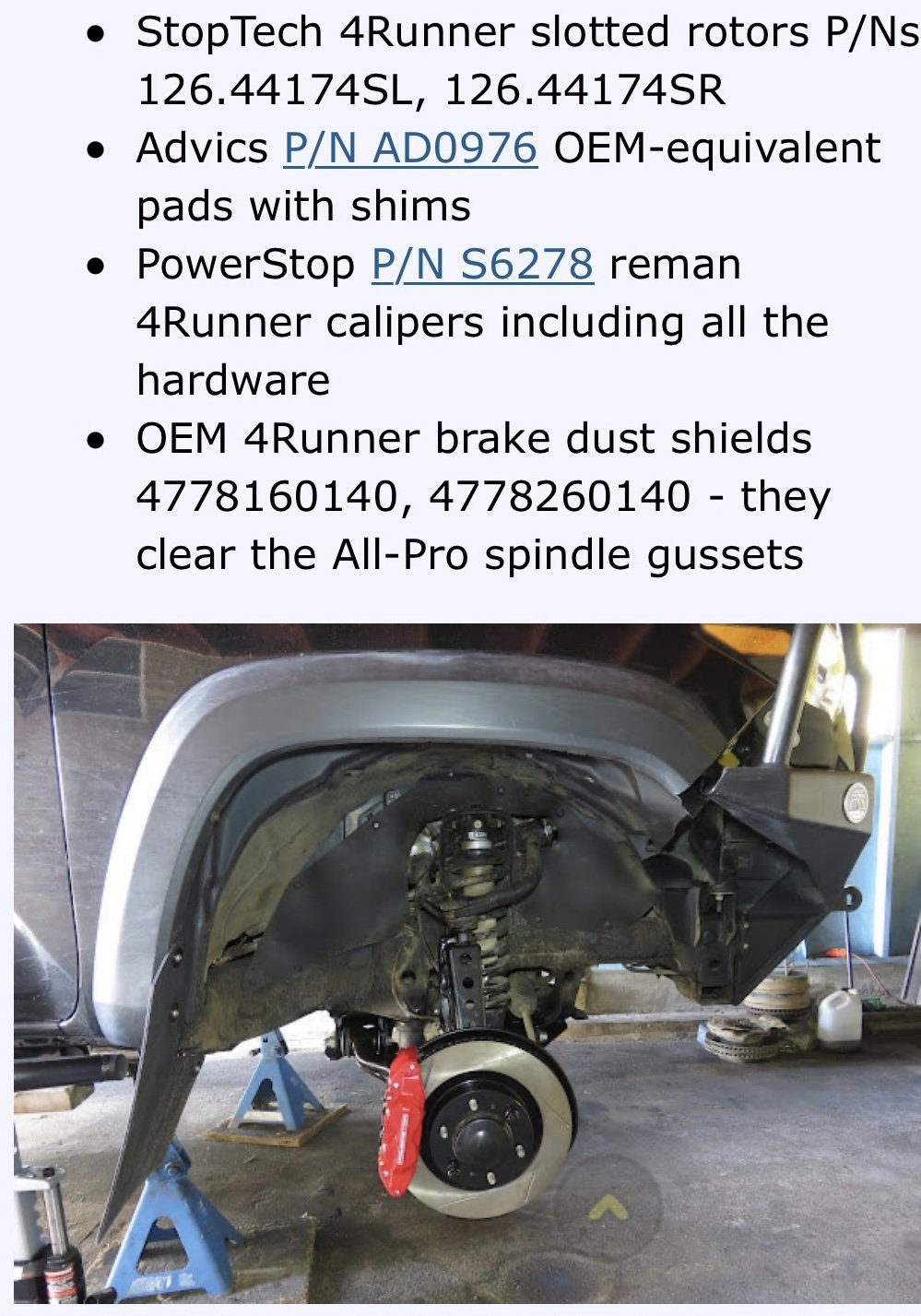

    Mind sharing part numbers and the like? I’ve noticed on my truck if you push the brake pedal once and immediately release and reapply that there is more force delivered by the calipers. Significant difference. New master and booster might help me out as well. Thank you in advance.

    Has lockers, a skewp and a bit of droop.
    https://www.tacomaworld.com/threads/my-2006-tacoma-brake-upgrade-edited.652471/
    I followed this.
    All the stuff you need except the brake line.. https://www.tacomaworld.com/threads...oma-marketplace.256079/page-697#post-29628387
