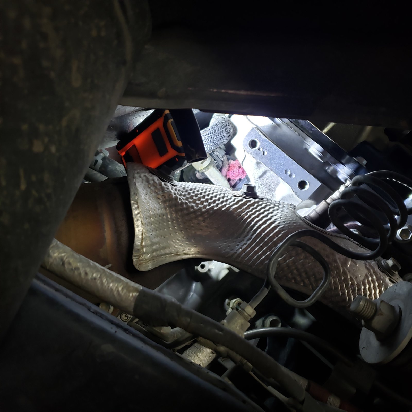

    It literally only takes 10 seconds to check on it with a flashlight.
    Lay under the passenger side, look up toward and pass the catalytic converter, above the bellhousing. If you see pink residue, you got the leak, if not, move on.
