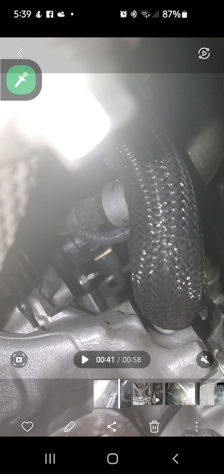

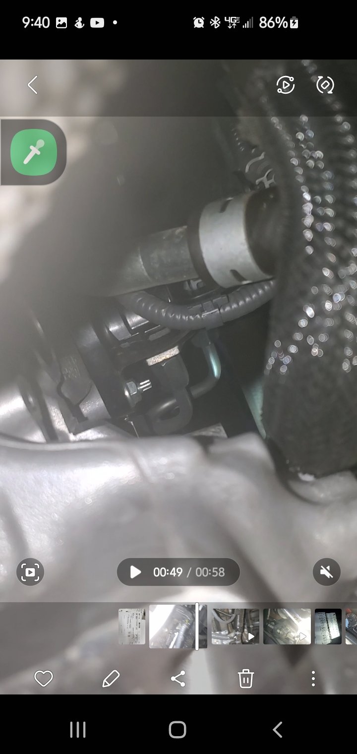

    I think I got the right area here. I just took my phone and recorded a video down in that area. I'm pretty tall, so it was easy for me to reach down.

    Is that the right area?

    I think I got the right area, wdyt?

    I can't tell from your one picture. Take more pictures and use a different light source, not your phone light.

    It was flash light used, a streamlight protac.

    You nailed it in your pic's. Passenger side from down under!

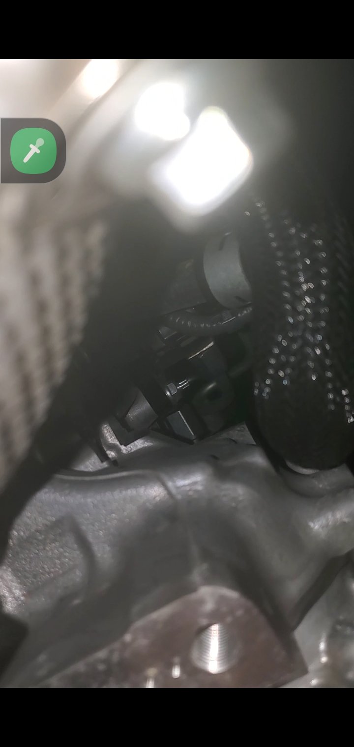

    Here's some more photos

    Oh your picture is upside-down. Looks good. You still have a virgin.

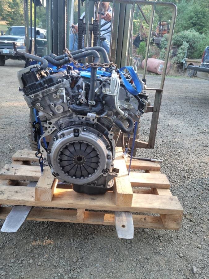

    Here’s a picture of the rear of the engine showing where this part is located.
