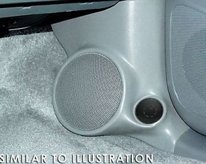

    I installed 5-1/4’s up front and 5x7’s in the rear. As stated above Crutchfield will show what fits. My 5-1/4’s needed a schosche “adapter” for it to fit the 5x7 holes. If you want 6.5’s you can make it work with a set of speaker enclosures that look like the kick plates by your feet. Like so

    You can make just about anything work. There is a YouTube channel where a guy customizes his 1st gen speaker doors to fit bigger speakers. I’ve seen one use fiberglass and another make it out of wood

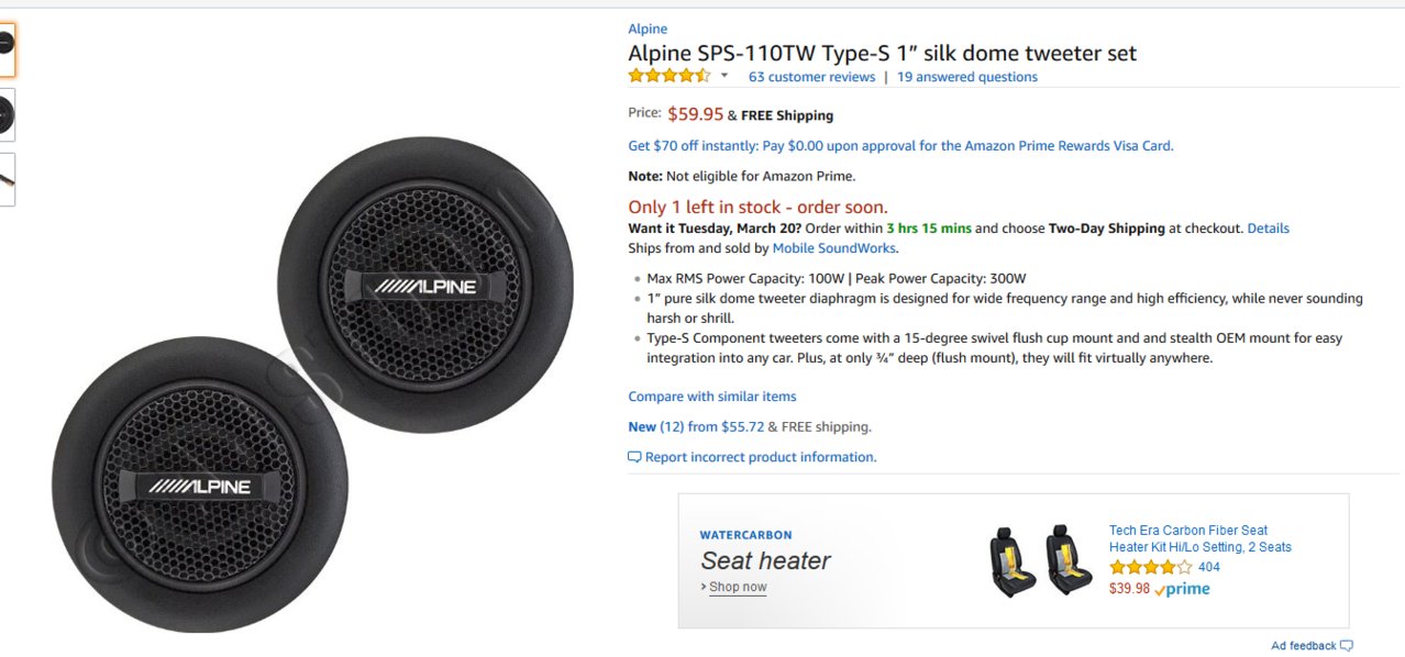

    has anyone replaced their tweeters and what did you get, ive already upgraded the speakers

    I replaced the factory tweeters on my 2001 Xtra cab with some regular Alpine tweeters. They fit right in and sound great!

    happen to know which ones, model number?

    I put them in the same spots as the old ones. They even fit under the old panel covers. You obviously can't use the Alpine grill/front this way, but it looks much cleaner.
