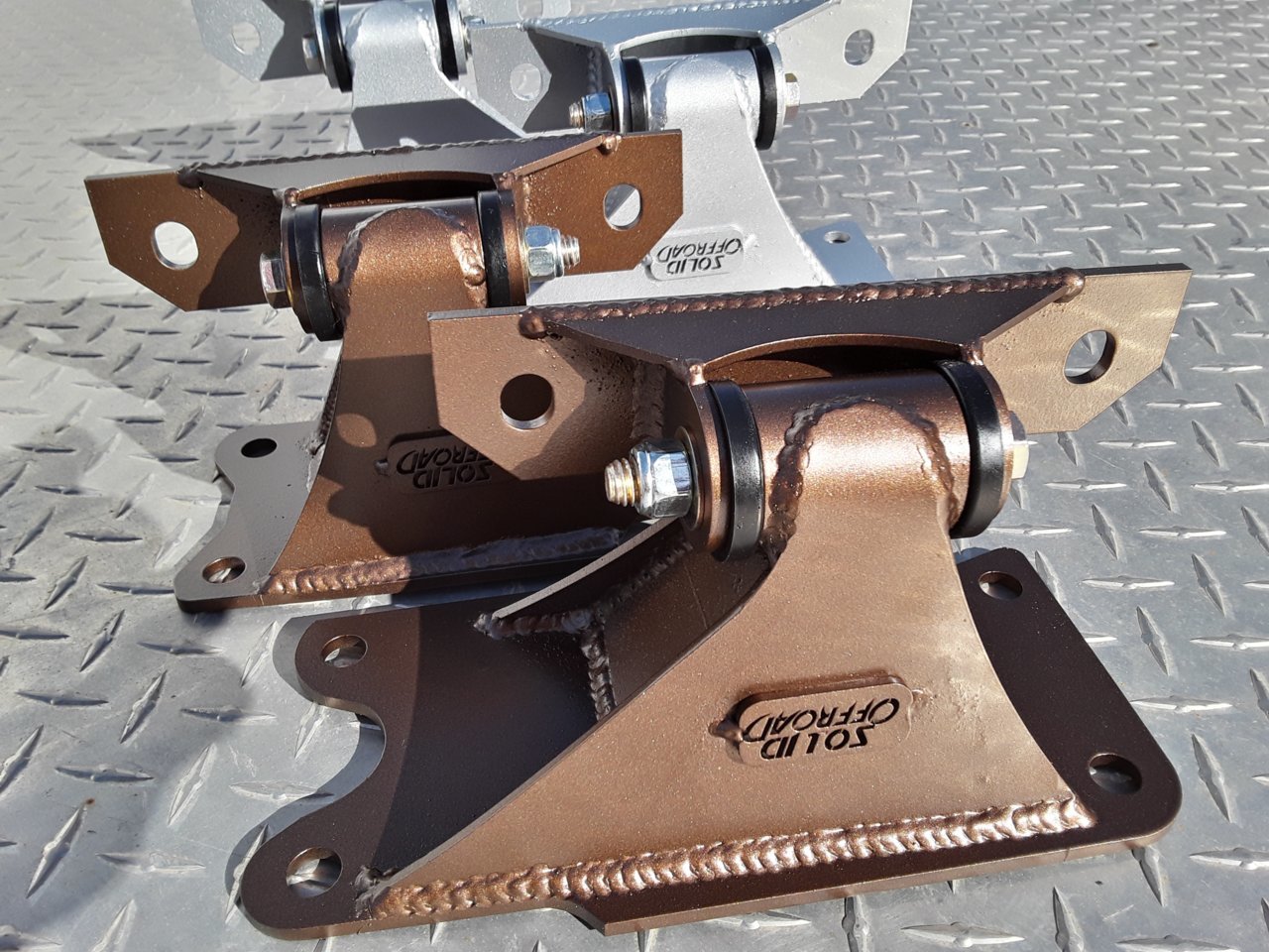

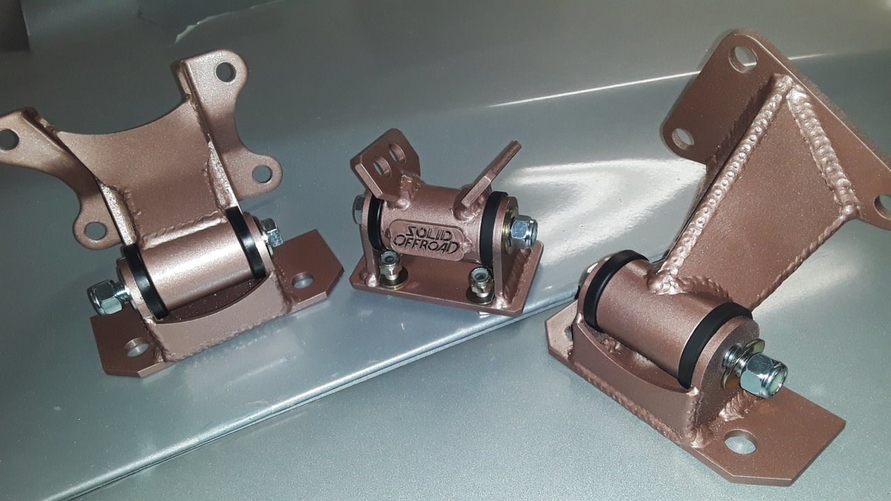

    Bonzen, do you have any pics of your mounts in bronze by chance? On your site, the 1st gen Tundra/Sequoia 4.7 pics look like they could be copper or bronze. Could you confirm which? Thanks

    This is the bronze

    Copper (almost looks like rose gold)
