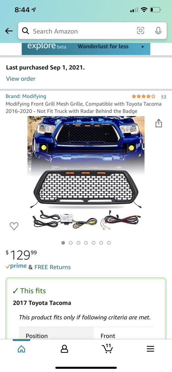

    Hey Everyone.
    I just bought a grille off Amazon, it’s called the modifying front mesh grill(attached picture). The wiring instructions are non existent, and the installation video that they send you isn’t for a Tacoma. I’ve done some research on it already, but I am new to a Tacoma. It has the wires to hook into the TRD/Limited Led lights, and has 3 wires that are supposed to hook up to the blue, green, and black and white respectively. But the sr5 does not have these. The blue is supposed to be the ACC, the green is for the DRL, and the black and white is supposedly for the headlights. Would anyone be able to guide on how to wire this up to the sr5, i have 2 wires already hooked up to the amber DRL/Turn signals from the connection box.

    Alternate option for White wire can also be tied to RED wire to the add-a-fuse on the Power Outlet circuit.
