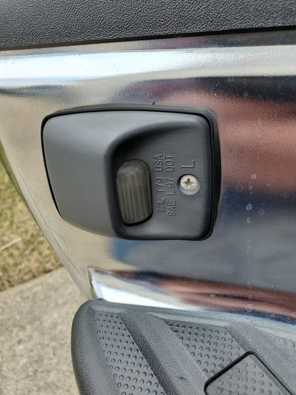

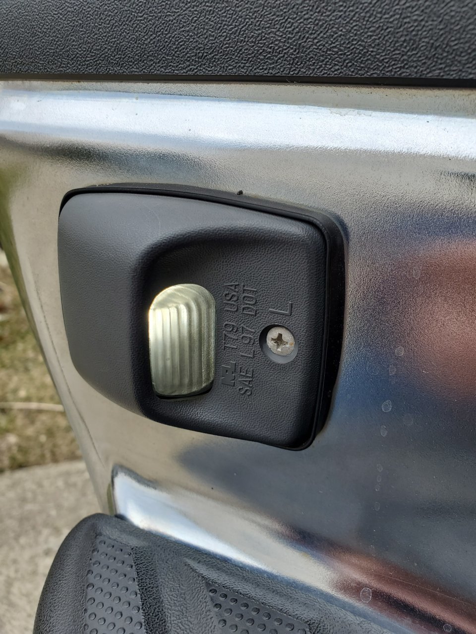

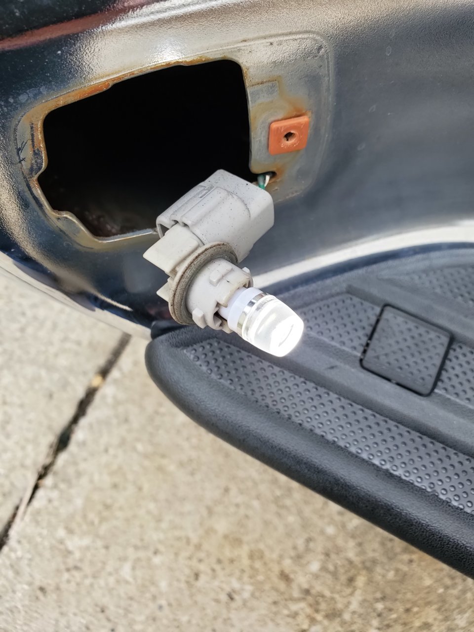

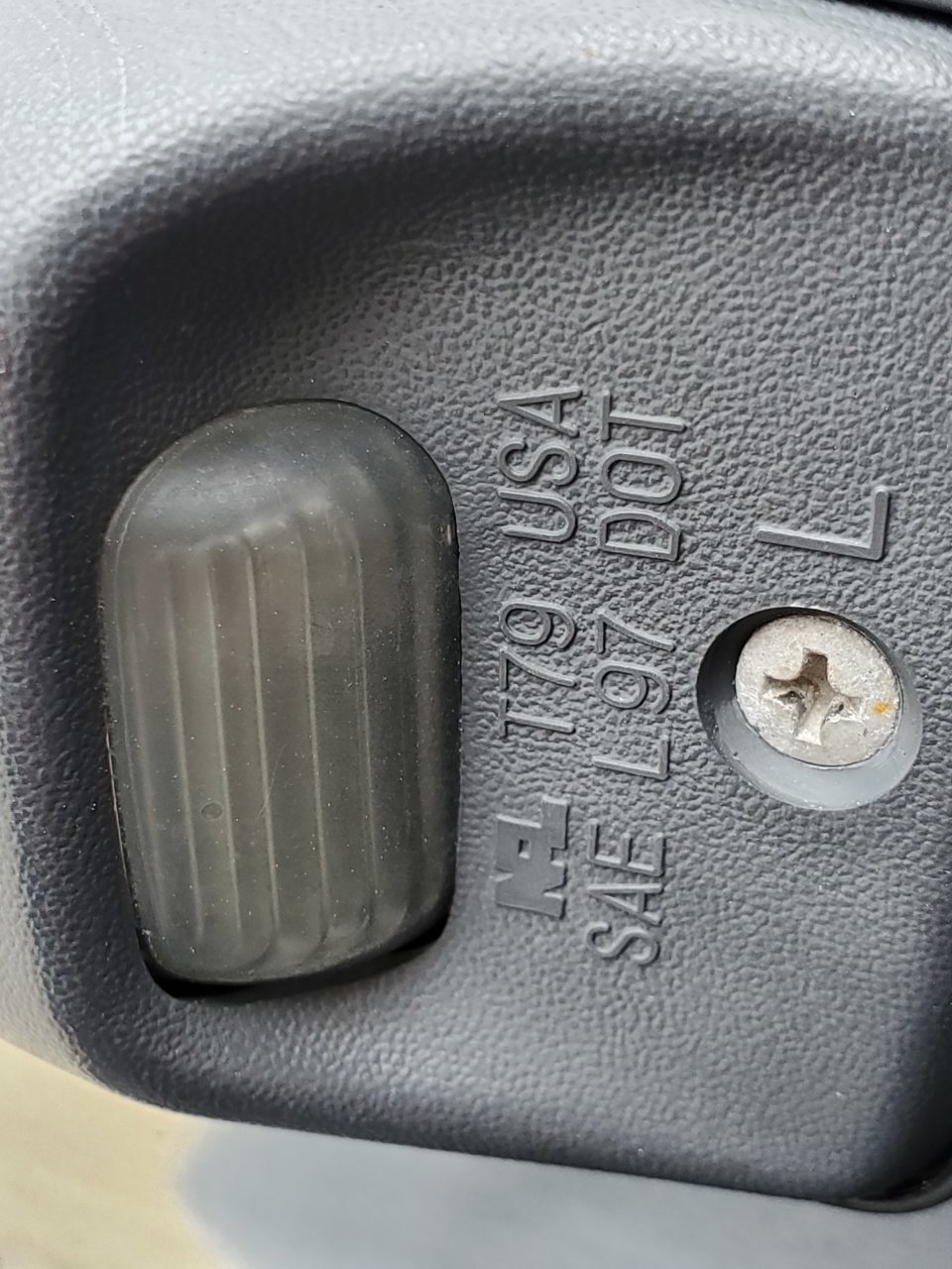

    Here are my factory lights, both illuminated and not, as well as the current style led bulbs that I was using. These were not the brightest of the various led bulbs that I have used, but they seemed to hold up the longest. You can see how faded the factory lenses are.

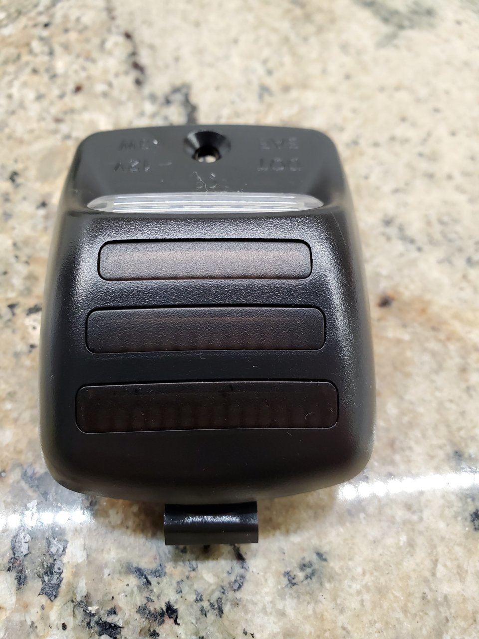

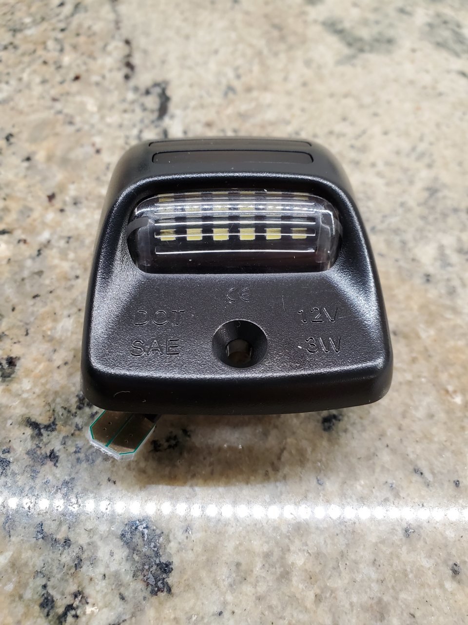

    Here's what the new lens / light assemblies look like, directly out of the package.
    You can see the multiple rows of white leds behind the lens

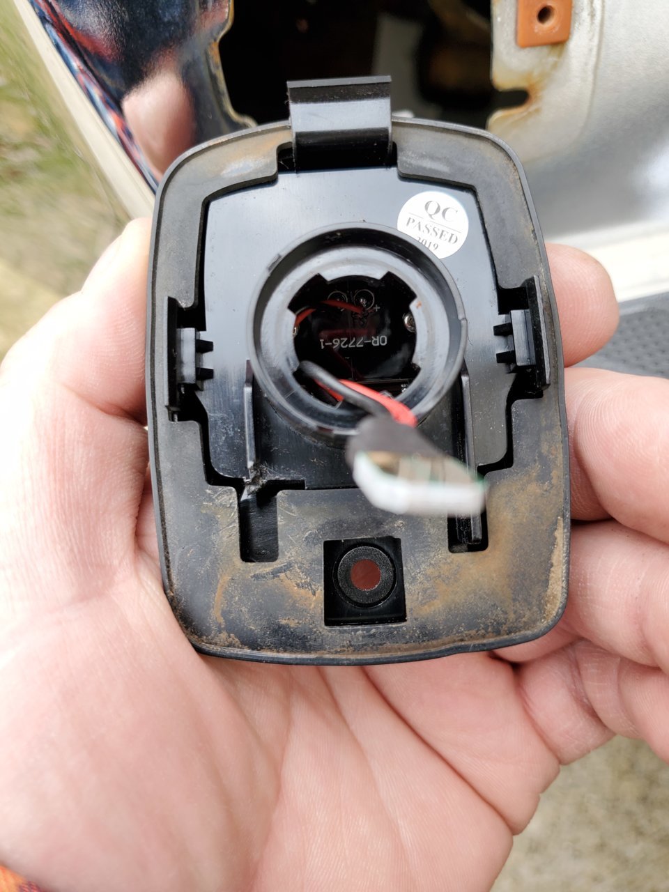

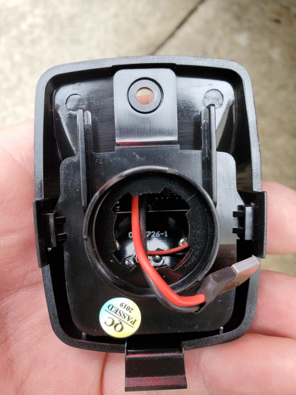

    Here is the pigtail that plugs into the factory 194 pig tail, then gets inserted and twisted into the housing just like the factory one
    And the 3 red led strips

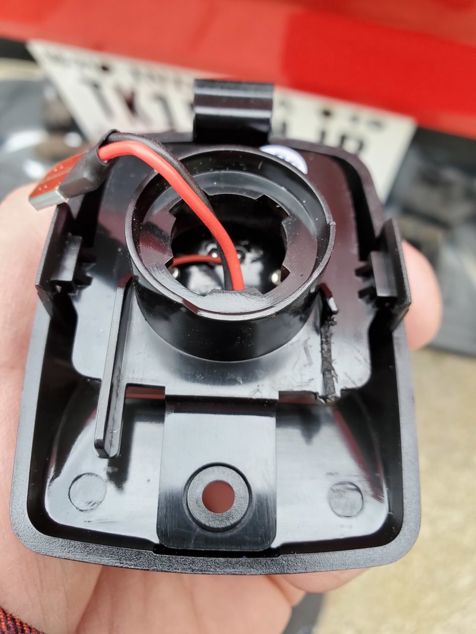

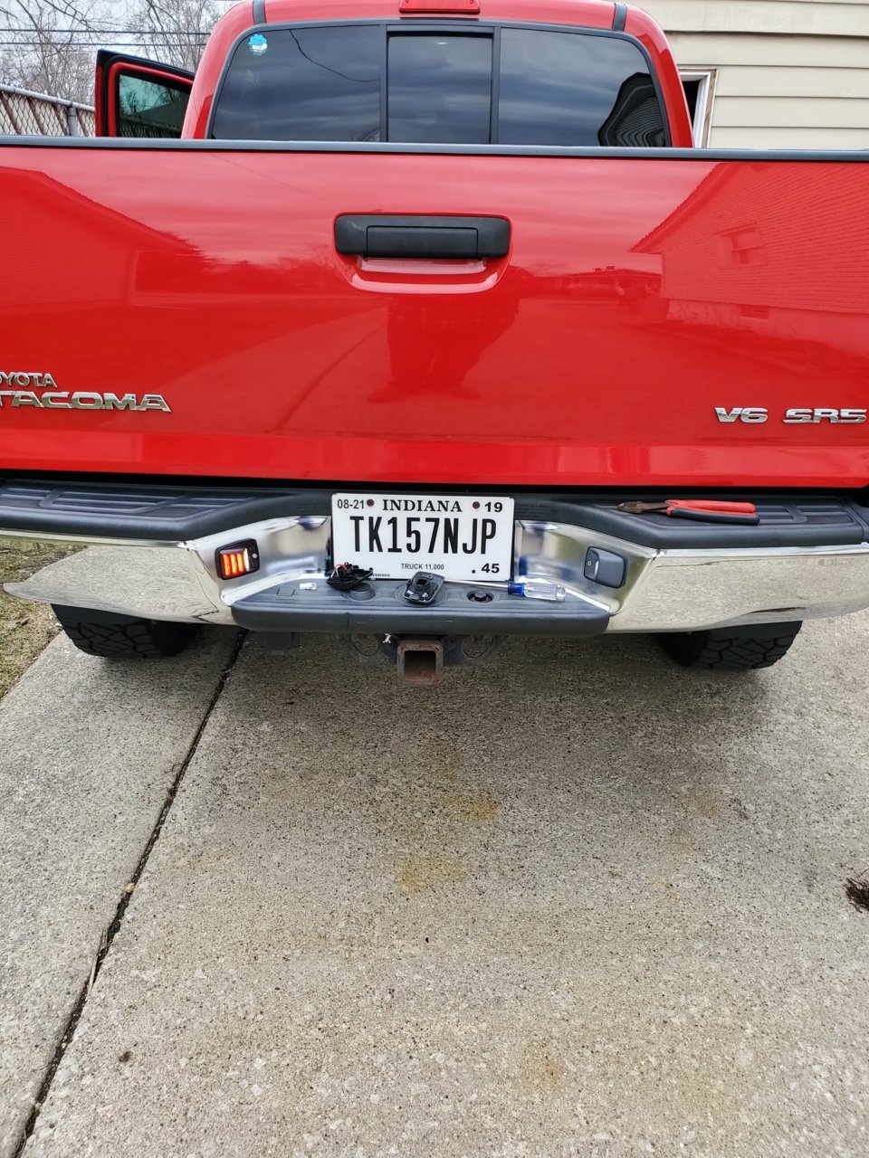

    The installation was pretty basic, but you do need to trim one alignment tab off of each light. Which one you trim, will depend on which side of the license plate that it gets installed. The bumper only has one slot in it, so it will not sit flat unless you trim off the end of one of the alignment tabs.
    Here it is, as received, with both alignment tabs on it.
    Here is what it looks like after using some side cuts to trim one of the alignment tabs. (for the opposite side, you will be trimming the opposite tab off)
    I did try plugging in the connector in both directions, and they do not seem to be polarity sensitive at all, so that makes installation even easier.
    Don't forget to remove the factory gasket from the factory housing, and install it on the new ones!

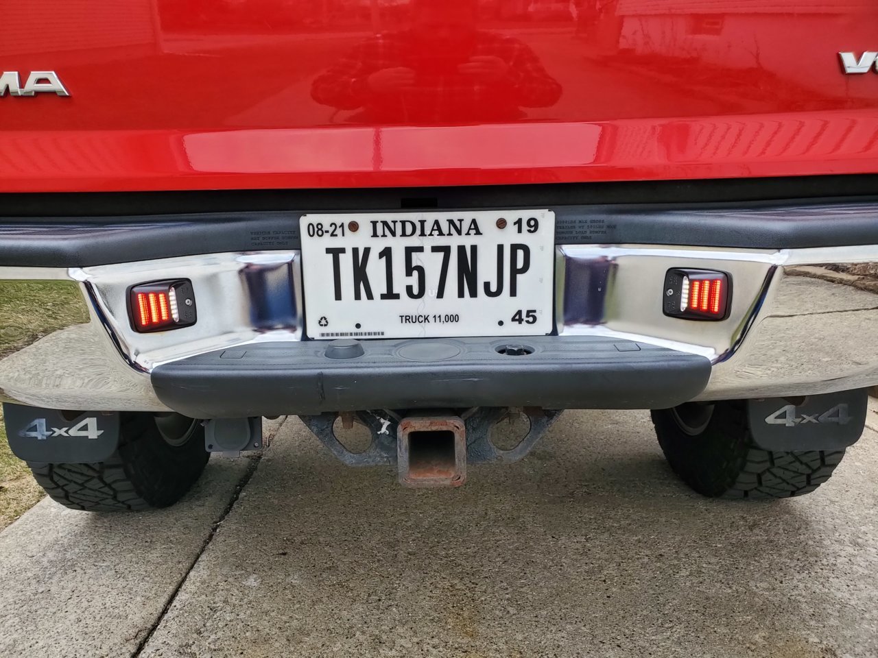

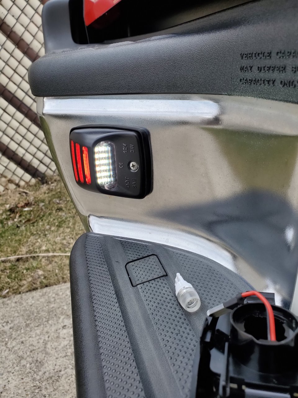

    Here is the as installed pics - in the daylight.
    20190328_134041.jpg 20190328_134103.jpg 20190328_134059.jpg 20190328_134055.jpg 20190328_134431.jpg

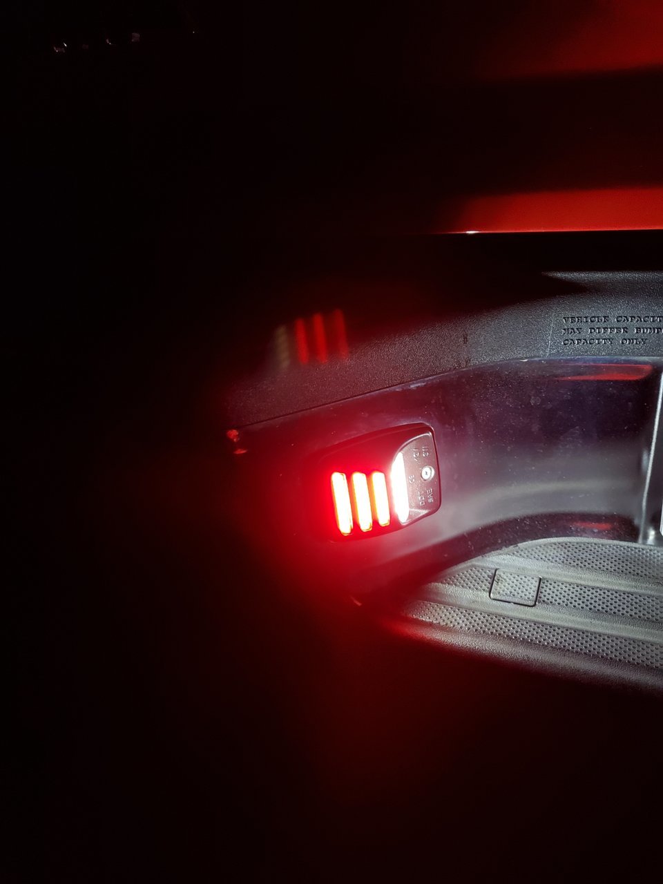

    Annnnnnddd.... Some Night shots!

    Unless that's your camera adjusting for the light it seems too bright, like one would be perfect. I kind of like it except all the light spilling on the tailgate.

    One last question. Are the red's constant on or do they come on with brakes?

    They would be always on unless he wired it into the brake light wires.

    As stated by another person, they are constant. They are only fed by the license plate circuit, so no way to make them do various things without rewiring them. And you would have to modify the internal circuit as well, otherwise ths white lights would blink as well.
