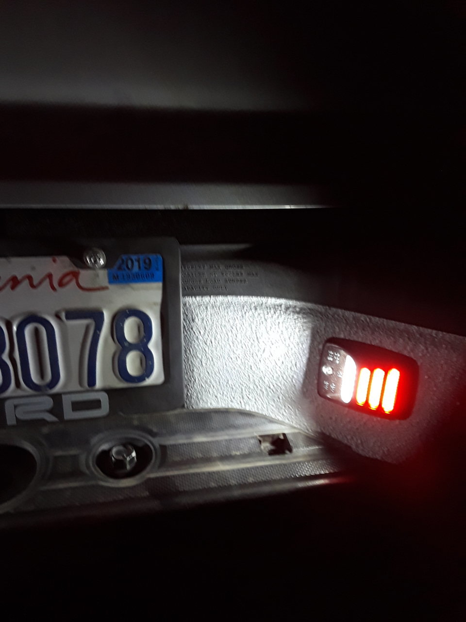

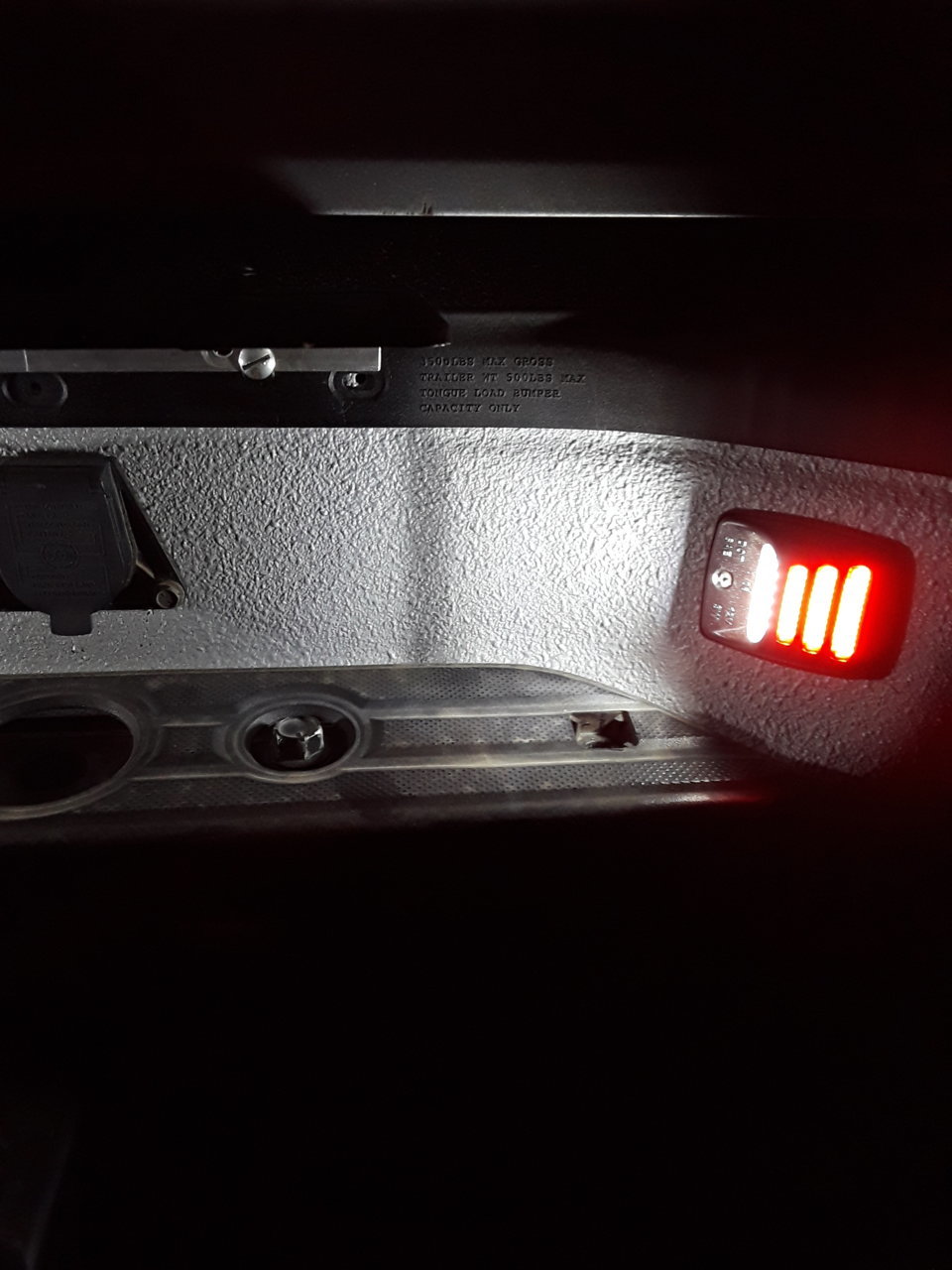

    Here's mine, gonna wire the red LEDs to the brake lights20190419_211841.jpg 20190419_211833.jpg

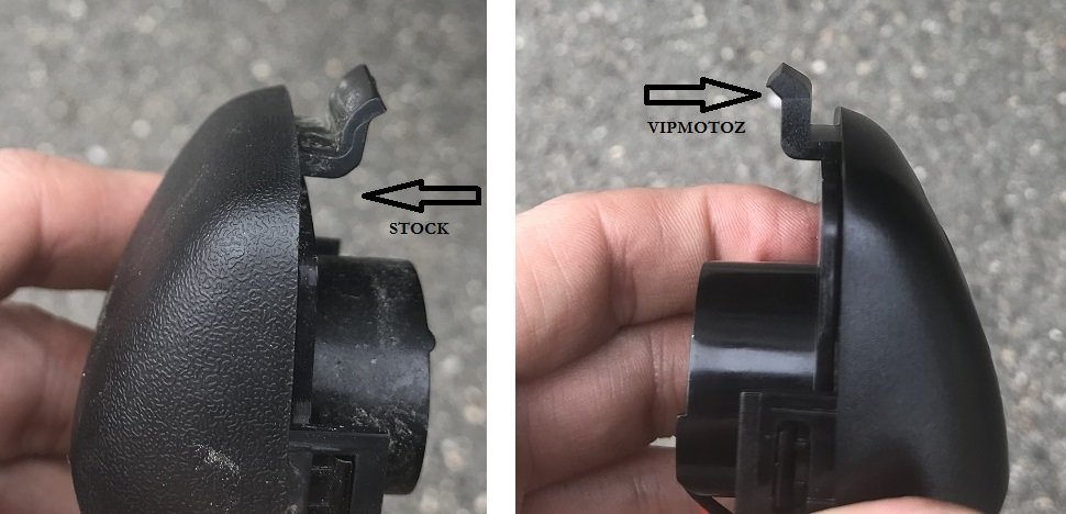

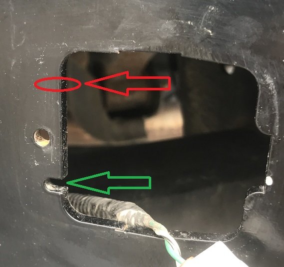

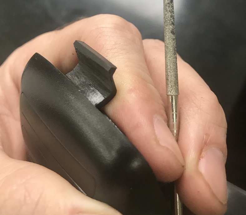

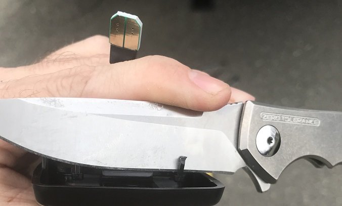

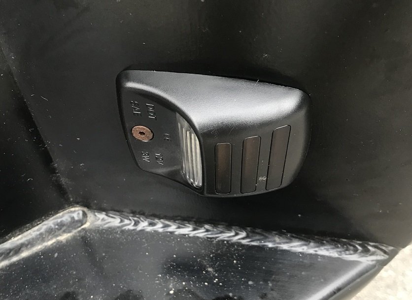

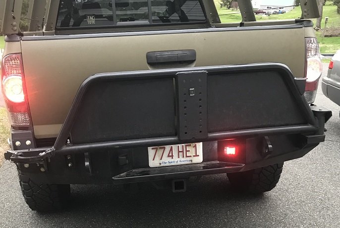

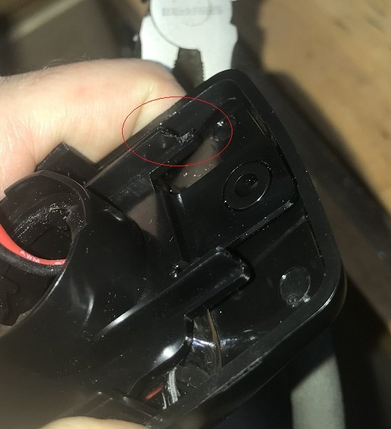

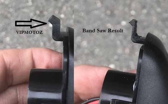

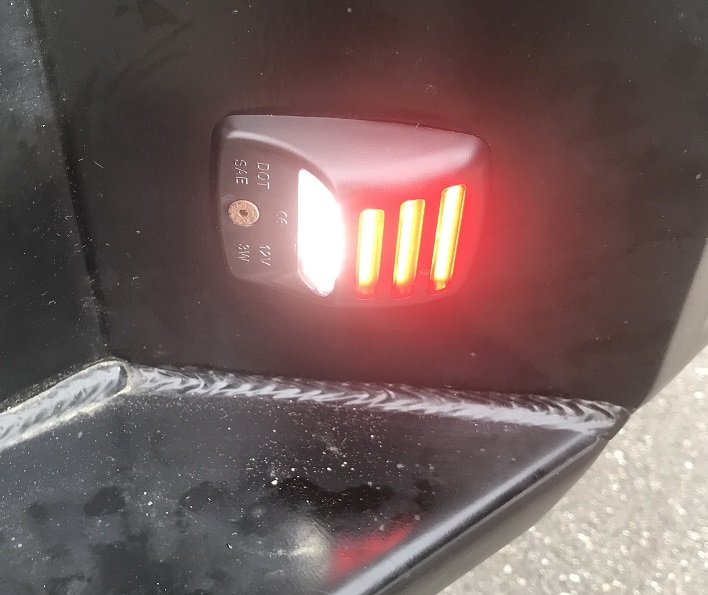

    I bought these and was stoked to get them on. After a few days of rain I had a window yesterday to install. The drivers side light is still fighting me and I cannot get the nut off. I'll tackle that one another day. I went to the passenger side and got that one off ok. But..........
    I did not think that there would be an issue installing because the stock lights were still on the truck even though I have a Fab Fours bumper which they are mounted on. I was wrong. The dimensions of things are a bit off and make it impossible to mount unless you mod. Here is my attempt at explaining what needed to be done to compensate for the thicker metal and absent slot.
    The tab that slides under the bumper is MUCH smaller than the stock one. Thus, the VIPMOTOZ will not fit over the much thicker material that the Fab Fours bumper uses. I took the part to my band saw to see if I could make it larger to fix the issue. Nervously I made the cut which went a lot less painful than I thought it might be. About two blade widths did the trick.
    Looks a but rough and the bottom was still a little problem with fit so I was able to remedy that with a few swipes of a file.
    I went ahead and tried to install but there was still a clearance issue. Took me a second to figure it out but I noticed that the new light had a rib that the stock light did not have. That stock lights rib was taken into account on the Fab Fours bumper which had a slot where that would go. It did not however have the sister slot needed to allow the new light to be able to fit. (of course now I notice this little gem is already covered in the original post!! I dislike my brain)
    So I took my knife out and sliced a piece off which appeared to work well. The part fit, but just not deep enough. I then had to take a pair of snips to remove the plastic underneath that rib which was also causing interference with the bumper.
    Once that was done it was almost ready but there was still some clearance issues. I decided that it was the plastic of the housing that needed to be trimmed so I carefully started pecking away at it with my knife. I don't have an after pic of this but this is the flat area that I trimmed wherever I could get at it. Just adding a deep chamfer gave me the clearance needed.
    And the end result. Apparently I have lost one of the rubber boots for these during the original vehicle build. Anyone know where I can get them?

    Wow, I just cut one of the little pieces off of each one and they slipped right on, ezee pezee and my bumper is covered with tintable bedliner to

    But, you can definitely see the thickness of the bumper being an issue when you look at the image. Unless there was another Tacoma option that I missed when purchasing the lights.

    I just used my original ones, I'm currently trying to hook the red LEDs up to my brake lights
