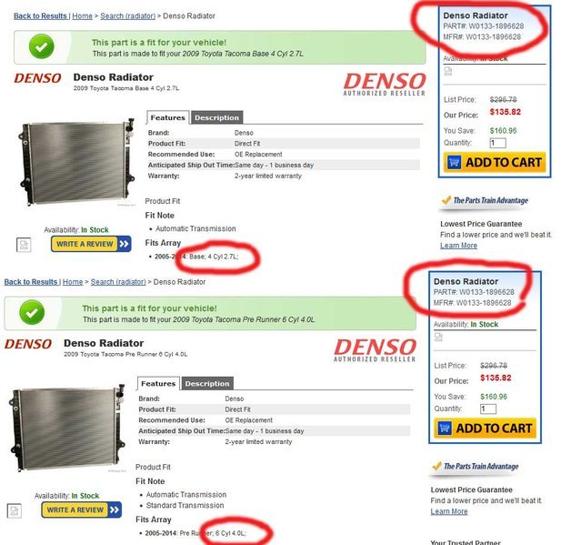

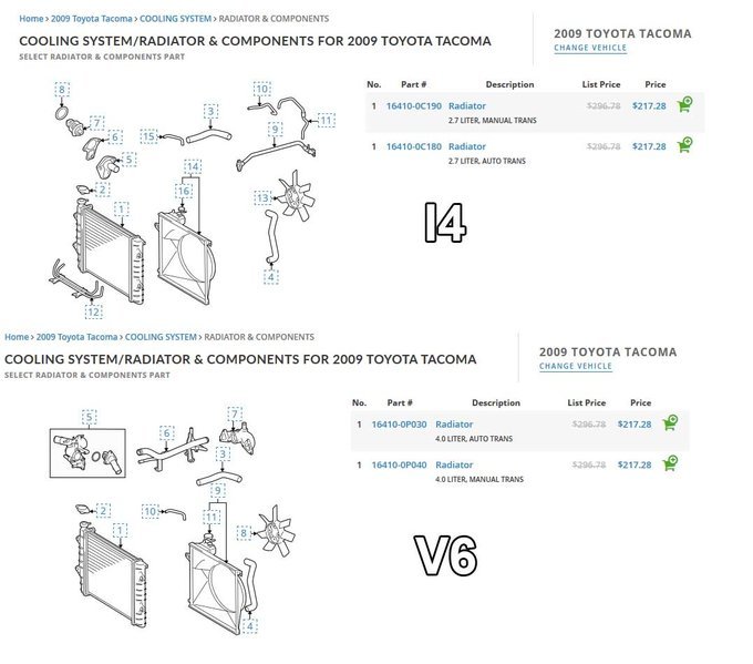

    For those that haven't followed in my build thread, there was discussion about me working with Ron Davis Radiators.
    Shout out to @Boring for researching and concluding that the 2TR also uses the same radiator.
    Also to @MrCrowntown for relentlessly affirming that it would fit the 2TR.
    Long story shortened, I sent them in an OEM radiator. Consulting back and forth, they have the finalized the design, and are ready to go into production.
    Basically every 1GR V6 Tacoma, from 2005-2015, can use this Ron Davis radiator. As well some or all 2TR Tacomas.* (Will be verified upon completion.)
    Within the next two to three weeks, estimated, I should have it in hand. Pictures will follow!
