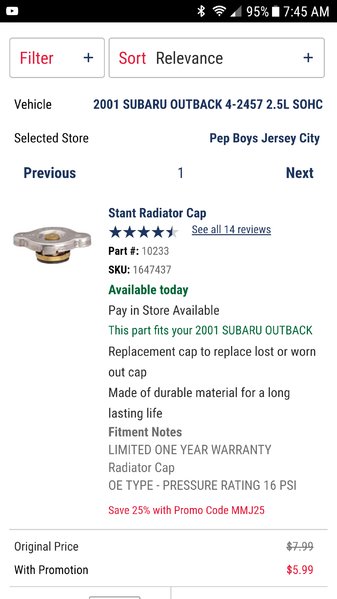

    Here is the radiator cap number.
    Stant # 10233. Being that it is off of a Subaru, the choice of aftermarket vendors' caps is a plenty.
    For the record, a #10233 is a 16 psi cap.
