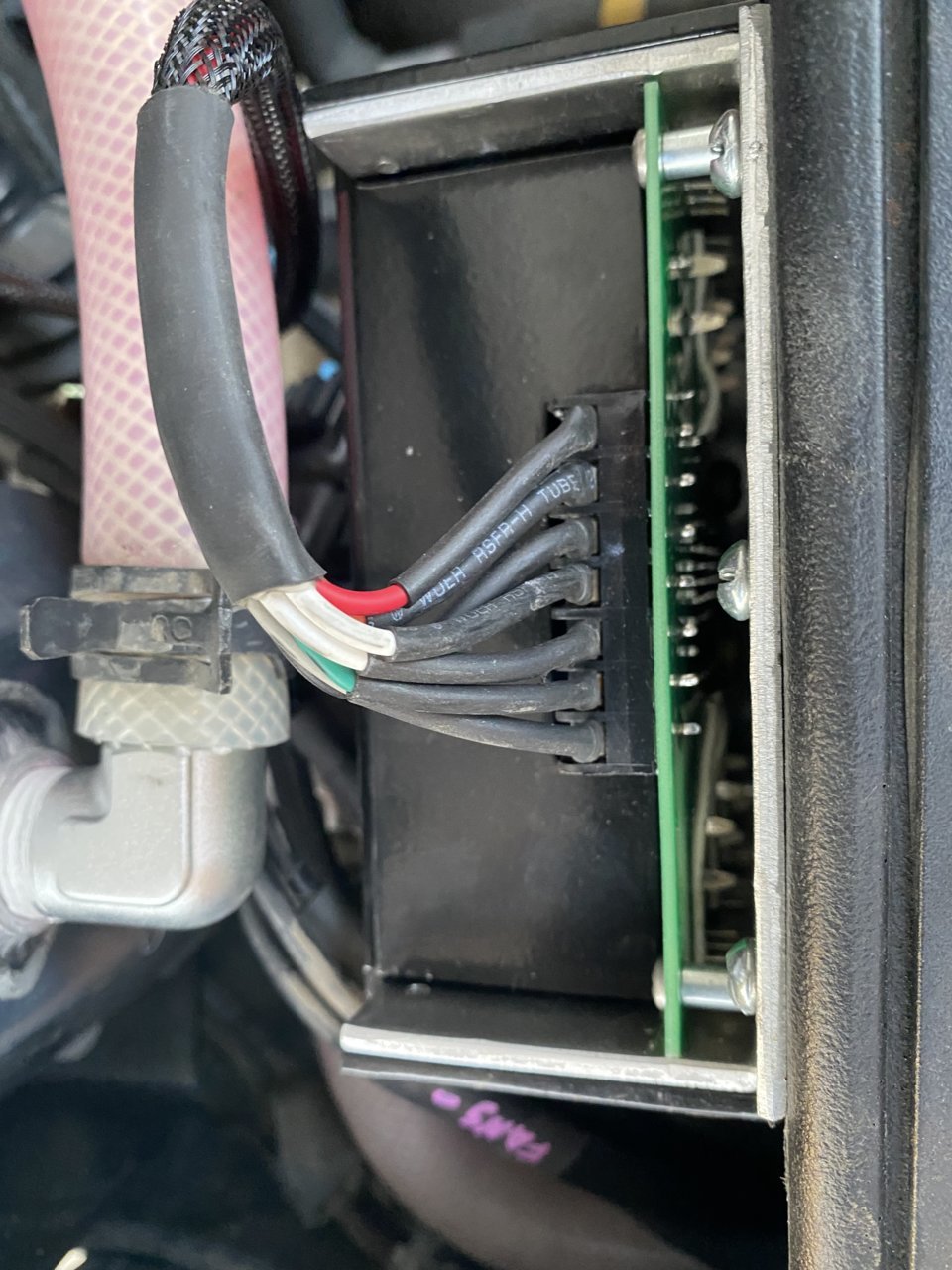

    Almost a year after I bought the HF controller, I got around to installing it today. Super pleased. It silenced the buzzing and vibrations coming from the Fans. Happy as can be. It you have standard Spal fans, This is the controller for you.

    Got pictures of it installed?

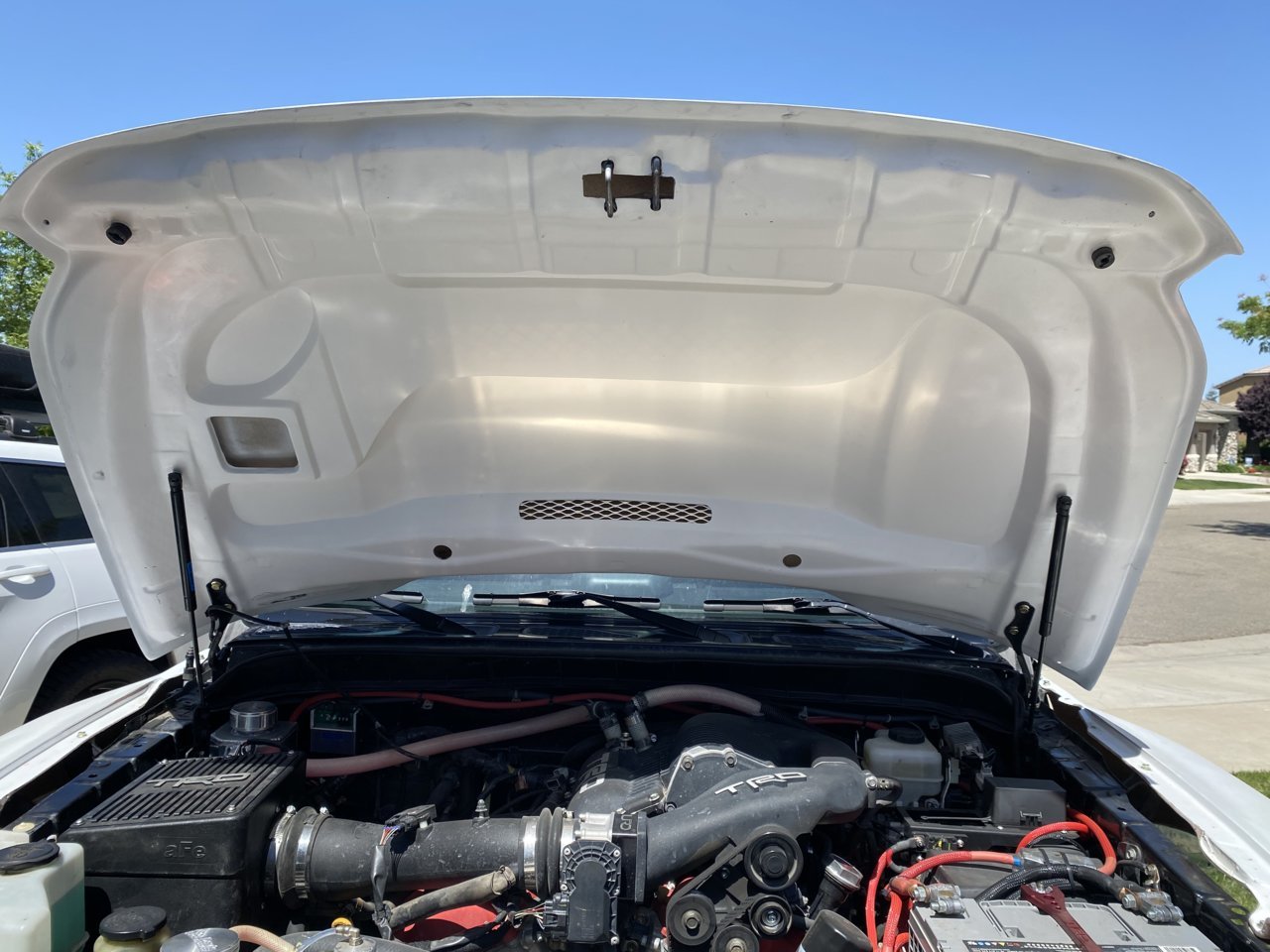

    It’s hard to see, but I mounted it to the back side of the afe air box. 3B63E165-4201-4FAF-A5CE-076EE1CC2637.jpg

    Slick spot. I like that.
