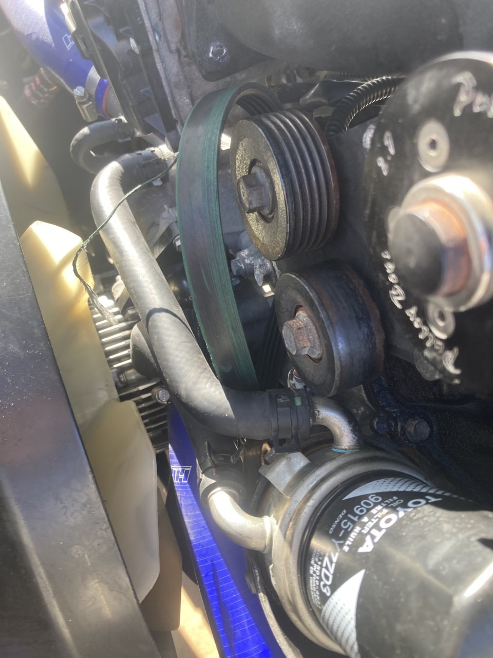

    Installed mine today. Old studs were loose in the block. The lower one was barely hand tight. This might be a factor of the stock studs snapping off. Wobbling while under load, threads exposed, would accelerate the weakening process.
    New ones in without issue.
