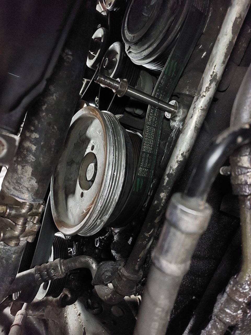

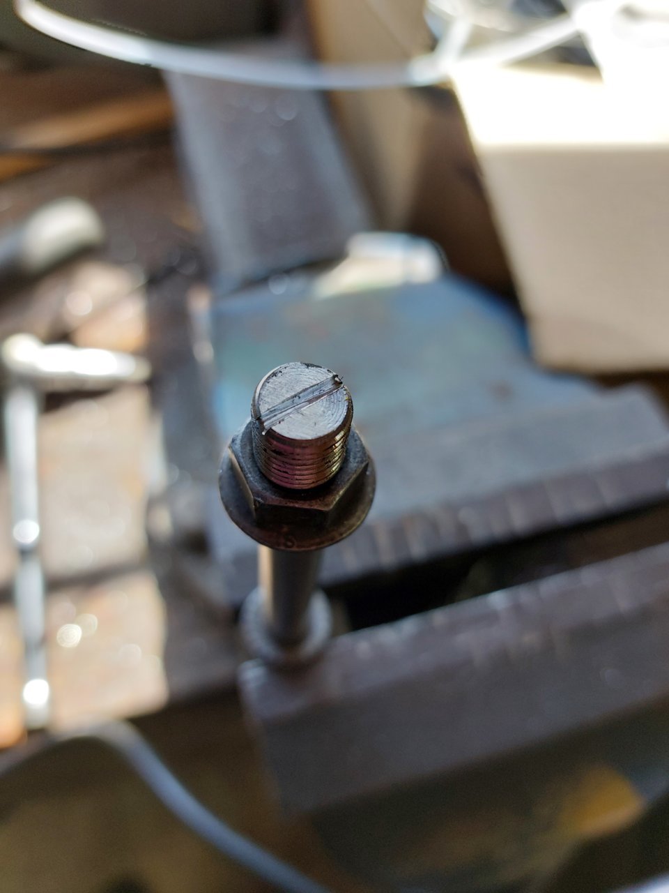

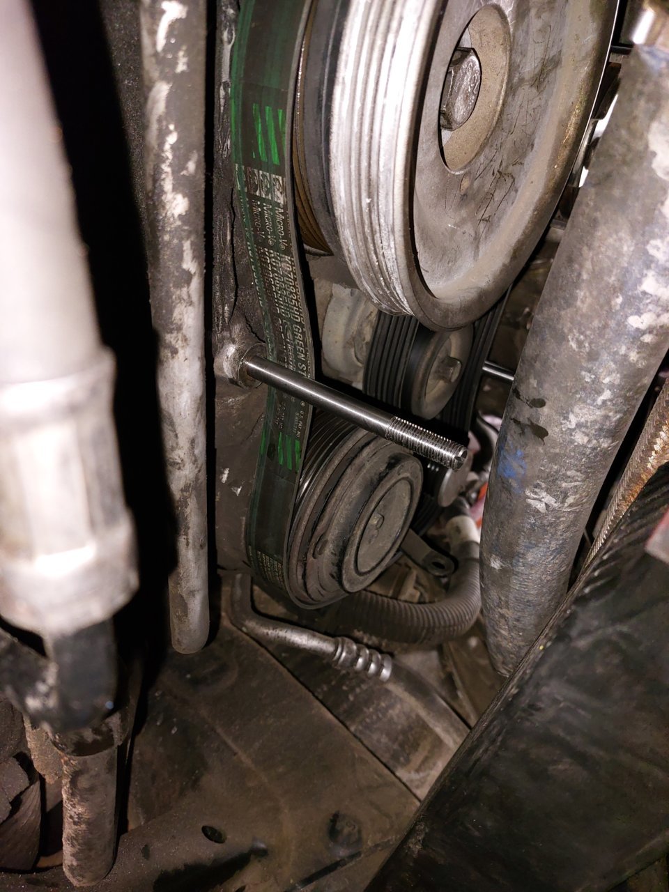

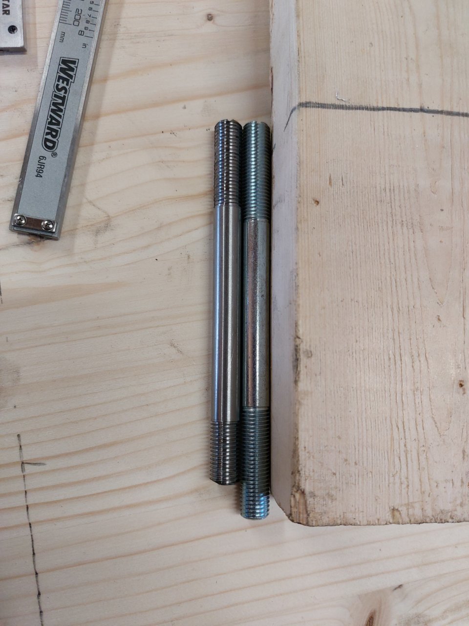

    The group buy closes with this post, however with the feedback from others that they'd rather see the final design before deciding to join, I'll gladly accept additional confirmed buyers after they see this post. Besides, the more buyers the better. This week I will start asking for PayPal payments from those buyers who are confirmed.
    First picture: the test fit and final dimensions of the design have been determined. These are 5.1" long, with 1.5" of threads on the nut end, and 0.78" of threads on the hole end (note this 0.78" is an exact field-fit dimension and was fully test-fit to be about 0.040 before bottom-out).
    Not bottoming out will allow the unthreaded portion of the shank to sit flush and allow the solid shank to take most of the cyclic forces so the threads won't have to. Picture for comparison to the stock stud.
    Next picture shows a 2.5mm slot in one end for safe threading.
    Last couple of pictures show the studs and how they will sit flush with the holes.
