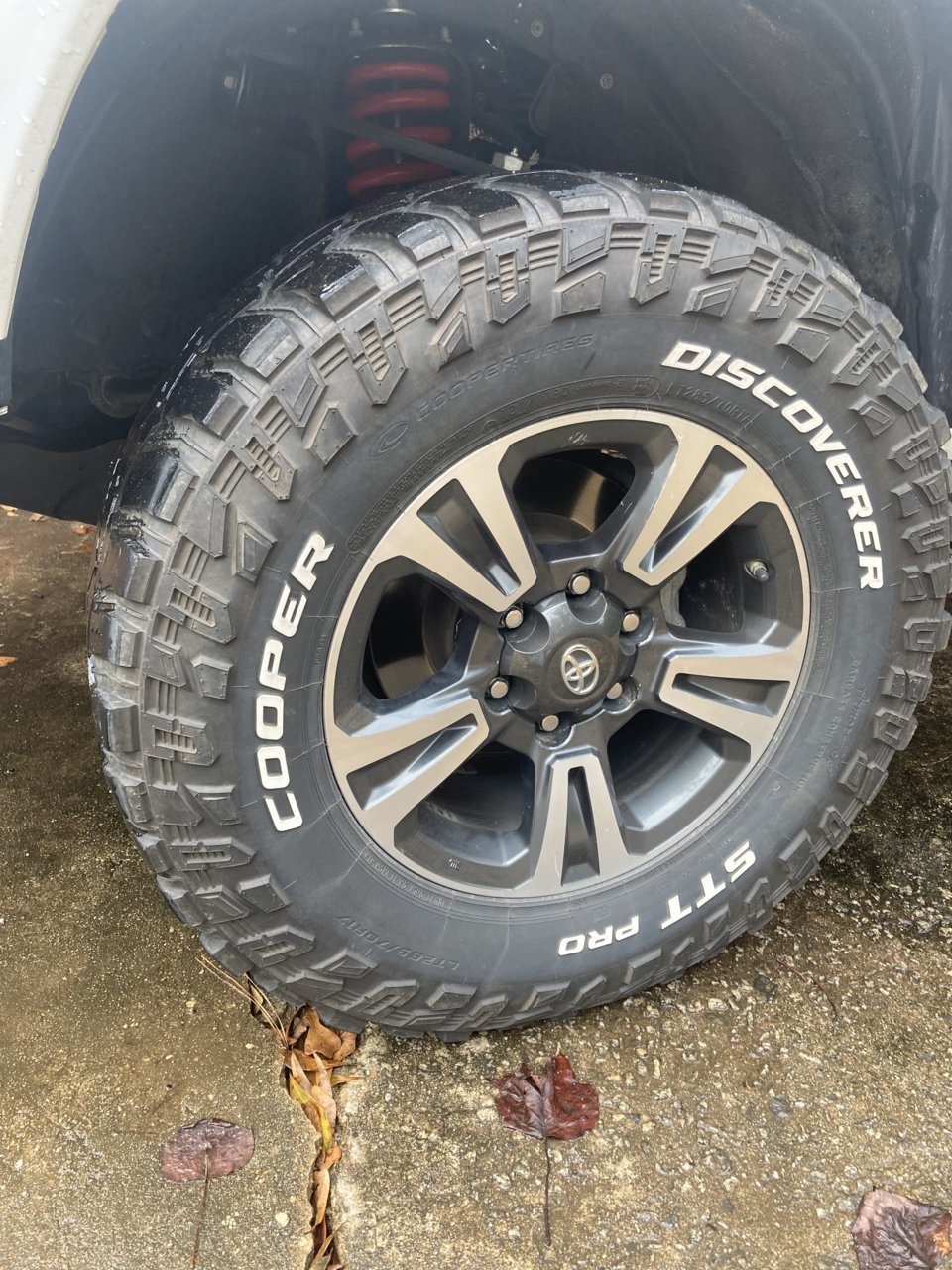

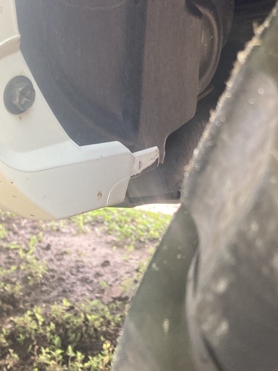

    FD651D43-0F86-402B-B681-D90C92EB9202.jpg FD651D43-0F86-402B-B681-D90C92EB9202.jpg
    Yep, 285/70 and I have 1” Bora wheel spacers and the exact same setup with the lift. The Coopers were GREAT…. Until they weren’t. Checked all my boxes. Looked phenomenal, rode good and quiet, performed good off-road, yada yada. Once they started to wear, totally different story. My truck rode like a warped wheel wagon. Truck rattled, shook, made noises it’s never made. I was legit worried they were going to cause damage to my truck. Like all the vibrations cause the ball joints to snap or something. Two of my best friends have the SSTs and they have the same exact experience with theirs. On two totally diff trucks, a F150 and a 2500HD. Never again.
    UCA clearance is fine and I only rub a tad. Turning into my driveway, there’s a dip, if I hit it just right- with enough speed, and almost at full lock, they’ll run a tad on the back of the fender. Otherwise no fitment issues at all, anywhere. You can see where the tire hits JUST ENOUGH to rub the paint off every once in a while. And those are BFG KM3s now and I love them so far.
