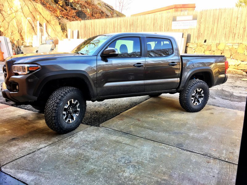

    I didn't do a full lift, just a 3/2 leveling kit, but I kept the OEM wheel with a 285/75/16 BFG KO2
