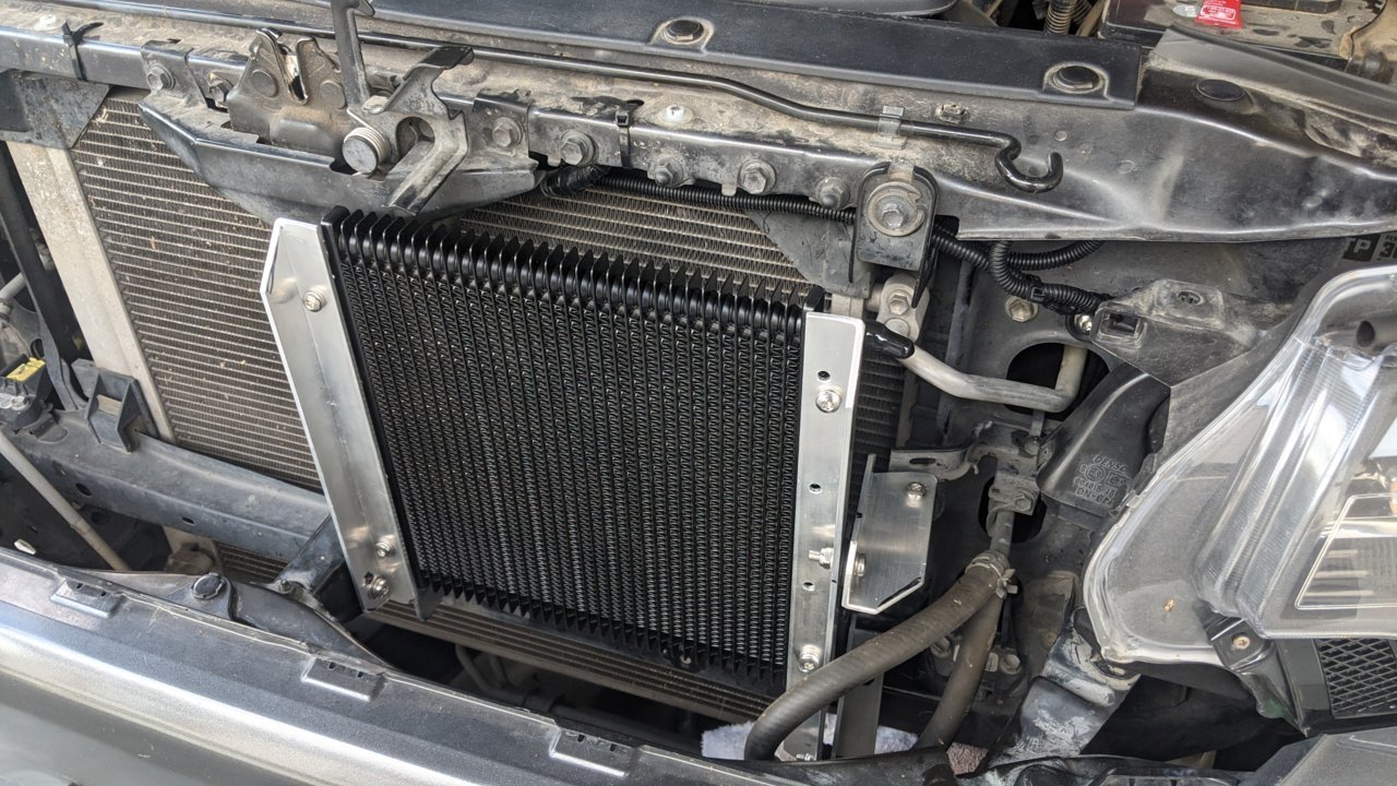

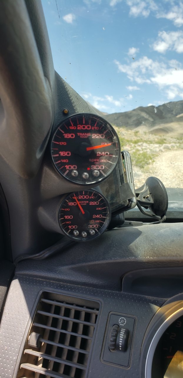

    I installed this cooler 8 months ago, it doesnt really do a decent job in keeping trans temps down when compared to the factory cooler. Which is why Im here, searching for a better cooler which is going to be B&M style. I monitor my temps with a Bluetooth App and aftermarket trans temp fluid gauge. My Mishimoto Radiator and C7 Corvette/Camero Electric Fan combo does a superior job with keeping the coolant system stable when its slow going up a trail at altitude or in high outside temps. I wish tue Mishimoto Trans Cooler could do the same.
    Here's the install info with pics https://www.tacomaworld.com/threads/monkeyproofs-misadventures.697489/page-7#post-27835139
    Heres a pic from a recent trip to Death Valley, notice the Coolant Temp on the Bottom and Trans Temp at the top. Outside temp was 90-ish going up a long incline with tires aired down. This recent trip that had me decided to find a better cooler.
