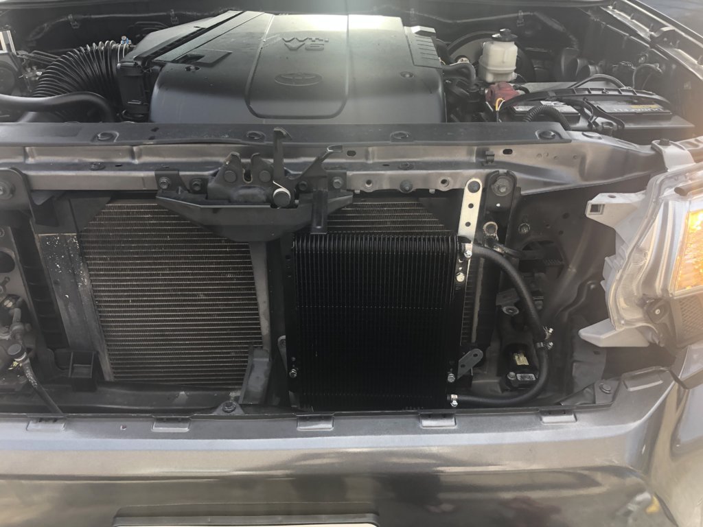

    2015 MGM TRD Sport Access Cab 4X4 V6

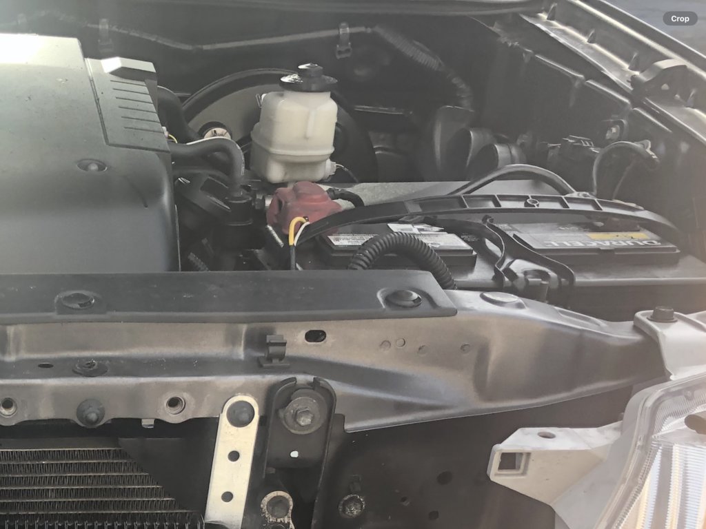

    Where you are relocate horns?
  6. Aug 6, 2025 at 7:35 PM
    #26
    Micbt25
    Micbt25 Well-Known Member
    Jan 12, 2020
    #315844
    621
    TM
    Up pass the battery, toward the firewall, there’s unused screw holes there and the horns work perfectly.
