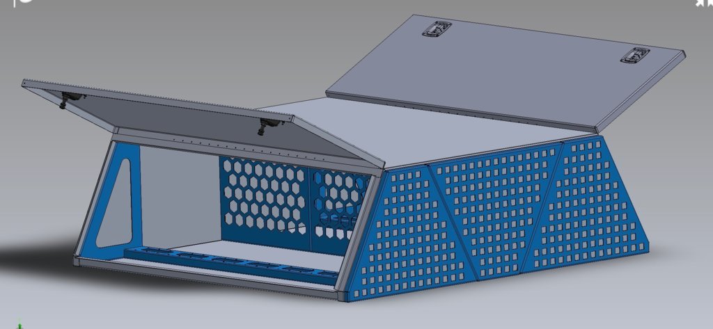

    I have a Tufport T65 camper on order, supposed to be ready in late July. I am trying to figure out what I need to do for the rear suspension, at a minimum, and I realized there's a lot i don't know.
    The camper is supposed to be 650 lbs empty. I will add a basic sleeping platform, so probably a few hundred pounds added once it has all the gear. And I'll likely have a couple hundred pounds of stuff in the back of the cab. Other heavy mods include aluminum skid plates, steel sliders, and I plan to install a high clearance rear bumper and hitch mounted swing out. I'll remove the tailgate, so that helps a bit.
