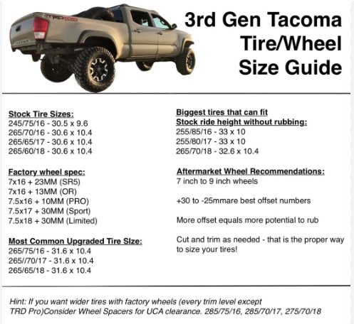

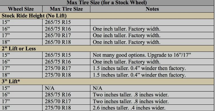

  3. Nov 22, 2024 at 10:08 AM
    TacoTime55
    TacoTime55 TT58
    Sep 28, 2021
    #378314
    9,880
    Ed
    Delaware
    2021 Midnight Black TRD Sport AT/DCSB
    TRD Lift,OTT Tune, LED HLs,TRDSkid, TalonCAT
