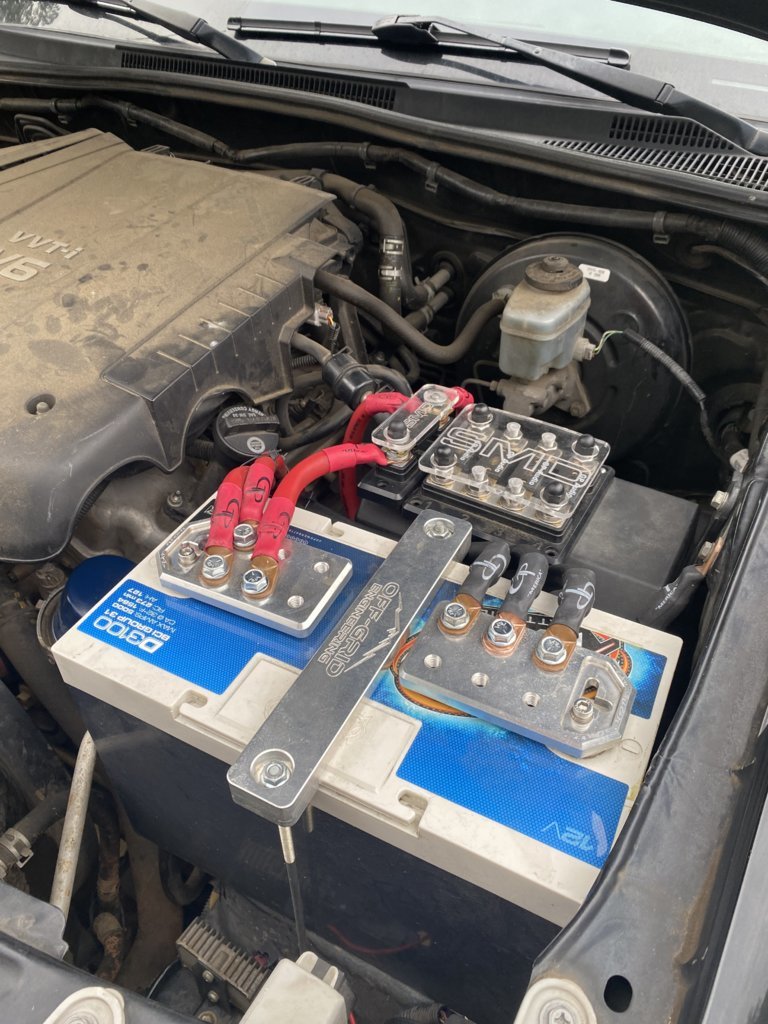

    Not sure how 3rd gens are wired, but I did this in my 2nd gen. Used a slightly larger gauge wire to tie my NEG bus into the same place on the fender where the stock wire was.
    Mostly for my OCD, but its also more flexible now.
    On a side note, I would not recommend using the frame as a return path for any high draw loads. Terminals and connections can corrode, get knocked loose etc. And the chances of any of that happening are a lot higher under the truck IMO. I would run a dedicated 2/0 NEG cable right next to your POS.

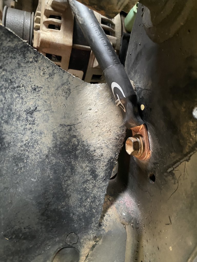

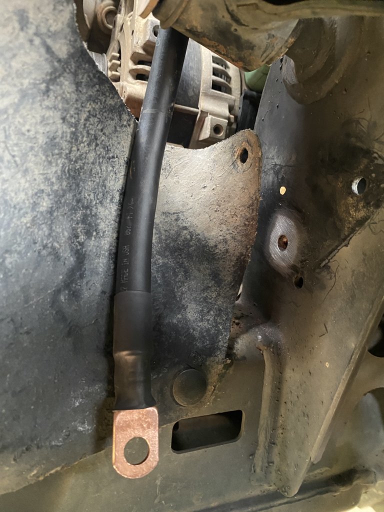

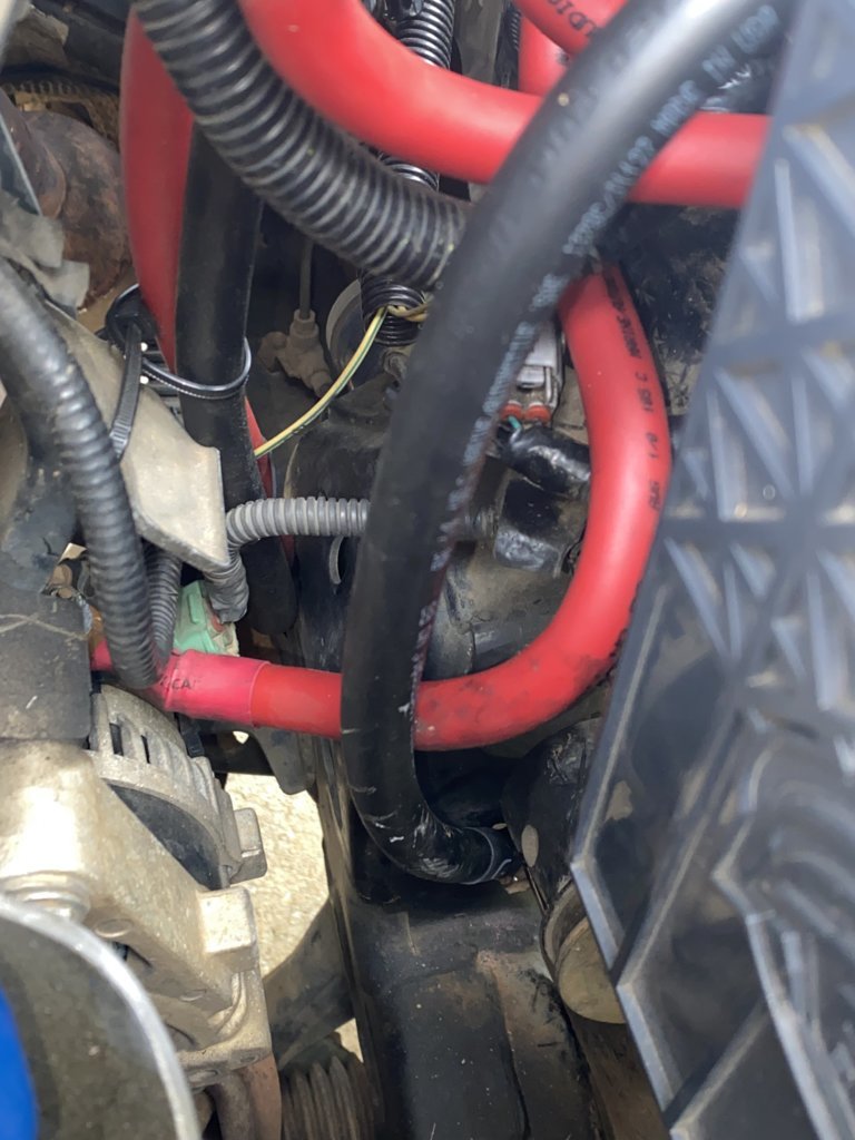

    ended up running a ground to the stock ground point on the LH front shock tower. super easy, 3ft cable.

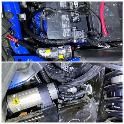

    There surprisingly isn’t much info on this even in the Big 3/5 threads. Many people just junk the frame ground entirely.
    Here are some more pictures if it can help anyone. (I need to buy frame paint, don’t leave it as bare metal PLEASE!)

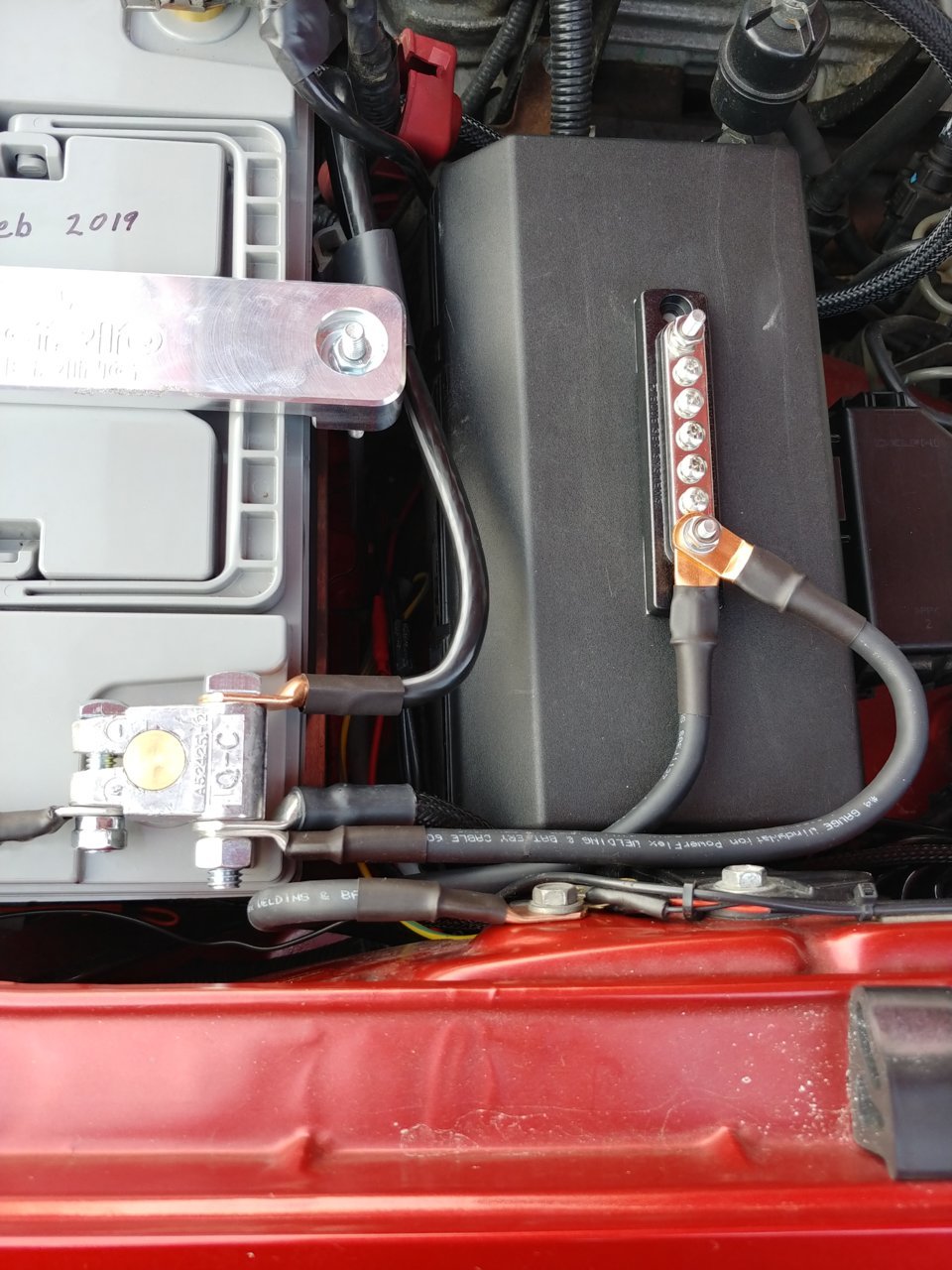

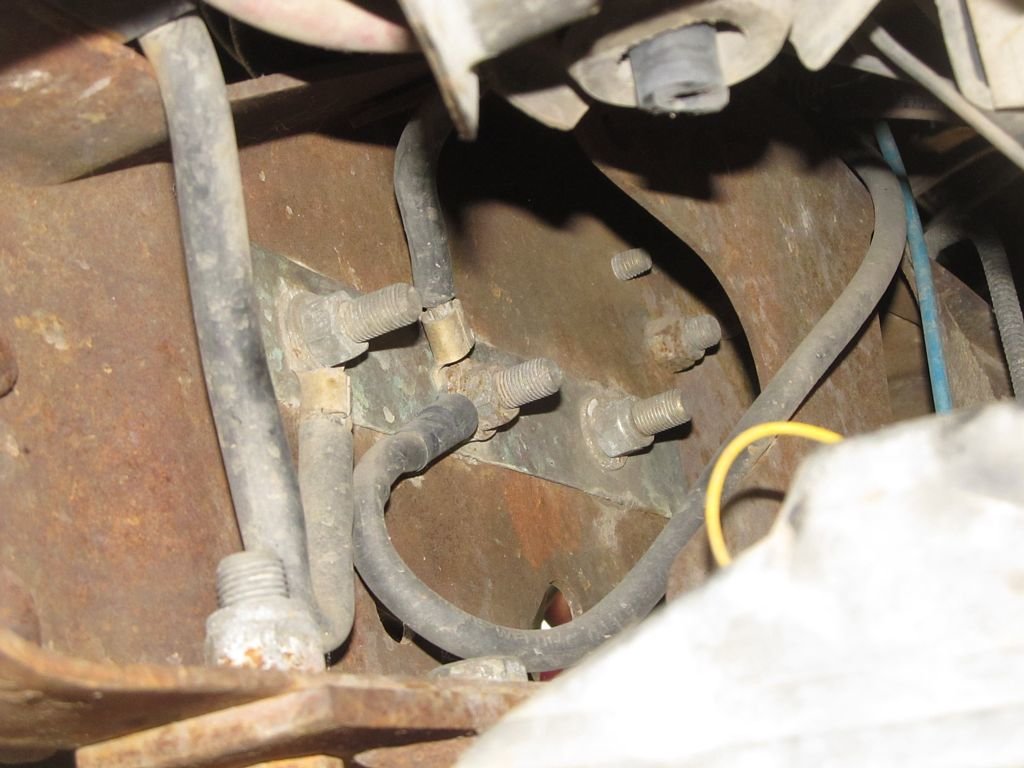

    I did something similar on another vehicle (putting the dual batteries under the rear to free up hood space/lower the CoG)...
    A good idea here (since use of a winch was mentioned earlier) is to put copper plates or strips w/multiple bolts where your cable is attached to the frame. Before the copper plate, I was getting some heat at the connections when running the winch due to the higher electrical resistance of the steel vs. that of copper. The copper plate & bolts spreads the current over multiple connections to the frame and reduces heating of the connection (reducing voltage drop as well).
    I also put grease between the plate & frame to help keep corrosion at bay.

    Ice job, is there any worries for ground loops?

    That’s a really smart idea. I have 3 1/0 ground runs that I have to do in the rear of the cab soon and I’ll probably apply this.
