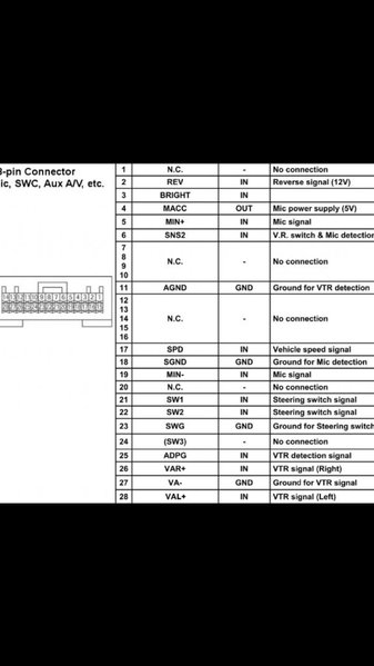

    ok, were getting somewhere. id like to know what else is in that plug. finding it hard to get a proper pin out. seems like its the same plug throughout toyota models and some subaru scion and lexus. there should be a vehicle speed signal as well as the temp sensor is in there too. anyone know where i can find a pinout?

    beautiful. thats what i was looking for :D
    thank you

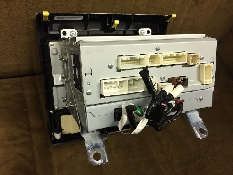

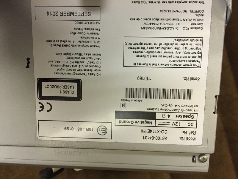

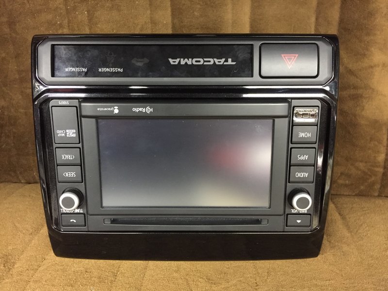

    hey guys, update on this thread. finally got my alpine unit fully installed and working great. looking to sell my entune stereo now. tried posting in for sale section but apperantly i dont have enough posts? anyways if anyones interested in the stereo let me know. the unit has the factory navigation as well as the bongiovi dps sound enhancer. what im looking to do is sell the complete unit, stereo, mounting bracket and hazard airbag piece. what im looking for in return is the hazard airbag piece with the stock clock in it. i would like the white lettered clock, from 2012 and up. anyways im open to offers, but will only sell to someone who can trade me the clock piece.IMG_1007.jpg IMG_1008.jpg IMG_1009.jpg

    not sure why the first 2 pics are upside down :p
