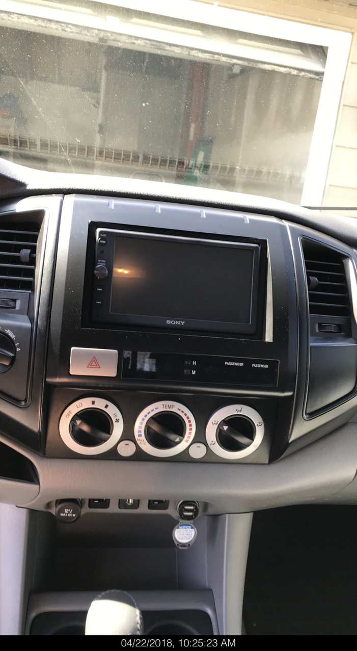

    I went with the Metra because mine is silver and textured. Wanted to keep it somewhat similar.

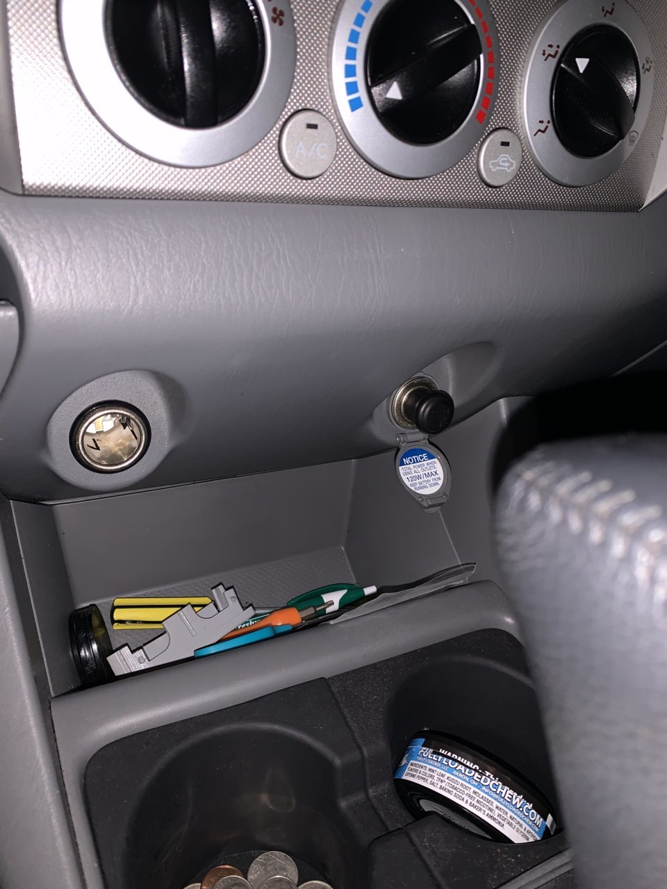

    also what year is your truck? I’d like to add those usb inputs between the cigarette lighter outlets in mine but mine isn’t flat. What did you use?

    I used idatalink, easy program with laptop and 50.00

    Mines a 2010
    SCOSCHE TA2053B Car Stereo Complete Basic Installation Double DIN Dash Kit for 2005-2011 Toyota Tacoma https://www.amazon.com/dp/B0014KOA42?_encoding=UTF8
