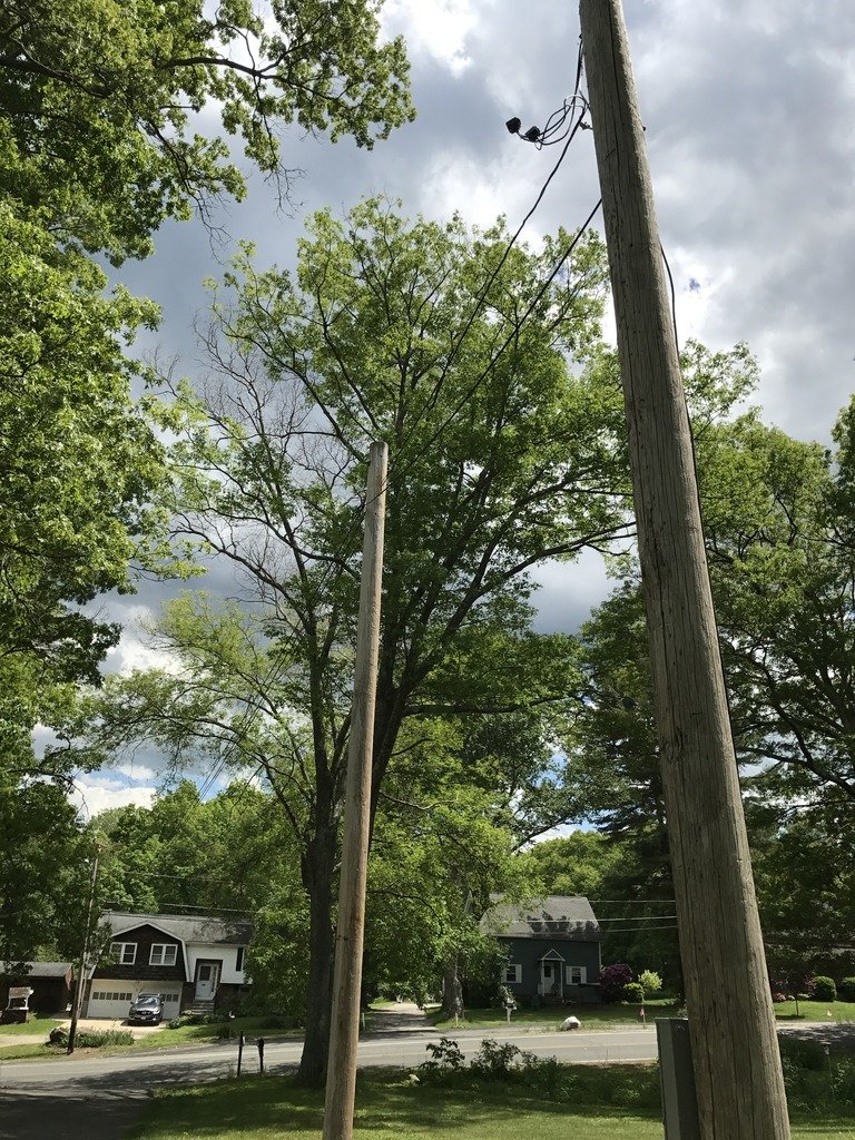

    The meter is on a full size utility pole so I'm not sure why it's labeled in the system as "temp". I talked to the electric company and they said they can send an engineer out to look and possibly just change the label to "permanent" in their system. Temp poles aren't supposed to stay up longer than a year here in MA and this has been there for over 12 years so I'm not sure what happened. I'm really hoping their engineer goes with the easy way, I'm not sure what is going to happen if we are told we need to spend money to remove the pole and move the meter. I just don't understand how the house has been sold twice with the current setup and nobody ever noticed it.
    As for price, we've gotten 4 quotes and went with the one who seemed most professional. One guy said we didn't have to upgrade and could just replace our panel for $1500, every other person said we are close to the limit with 100 amps and really need to upgrade. The guy we are going with gave us a quote of $3850 total.
    This is what it looks like, the one closer to the street has metal numbers on it so it's an electric company pole:

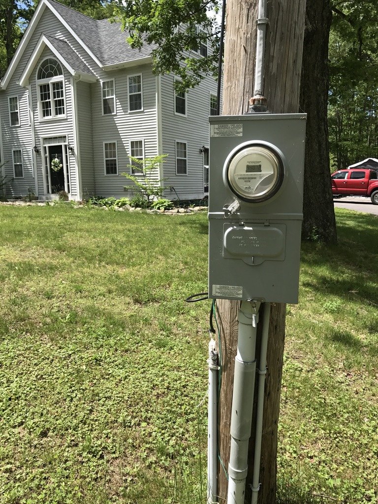

    I have no idea why the previous owners did what, IMO it would have made more sense to just put the meter on the house and have aerial wires from pole to house. Instead, the did underground conduit from the meter to the house. At least they made the conduit big enough to house 200 amp service, but again their choices make me scratch my head. If they went to the expense of updating everything why didn't they just install 200 amp service to start with?? Oh well, it could have been worse. When we were looking at houses we saw some that were nightmares just waiting for somebody to come along.
    The distance from the meter to the house is about 50ft, give or take. From pole to pole is about 20-30 feet, and from pole to road is probably about 100 ft.

    Ahhh, underground wiring! This makes sense now. Yes, I've seen many houses in SE Mass (Cape) with meters at the end of the property when the wires are underground. However, I've never seen them attached to a full pole. I imagine that's because they needed a pole for the drop where the meter was going to be placed.
