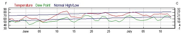

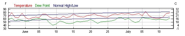

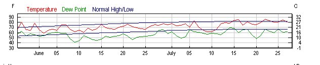

    Hotter summer = More A/C

    Right,but when compared to the previous 2 years? How much is 300 kWh extra use equate to?

    Circuit breaker short
    If you weren’t able to identify any other causes of your high electric bill, there could be trouble with your home’s wiring. Sometimes shorts occur in the circuit breaker that can drain power and jack up your bill. Turn off all the individual circuits in your breaker and turn on one at a time and watch the disc spin. Do this one by one. If you see one particular circuit that has a very fast spinning disc, it needs to be addressed.
    2016 Boston
    This year
    Also it could be that someone adjusted your A/C to a lower temperature, or you're running more laundry etc..
