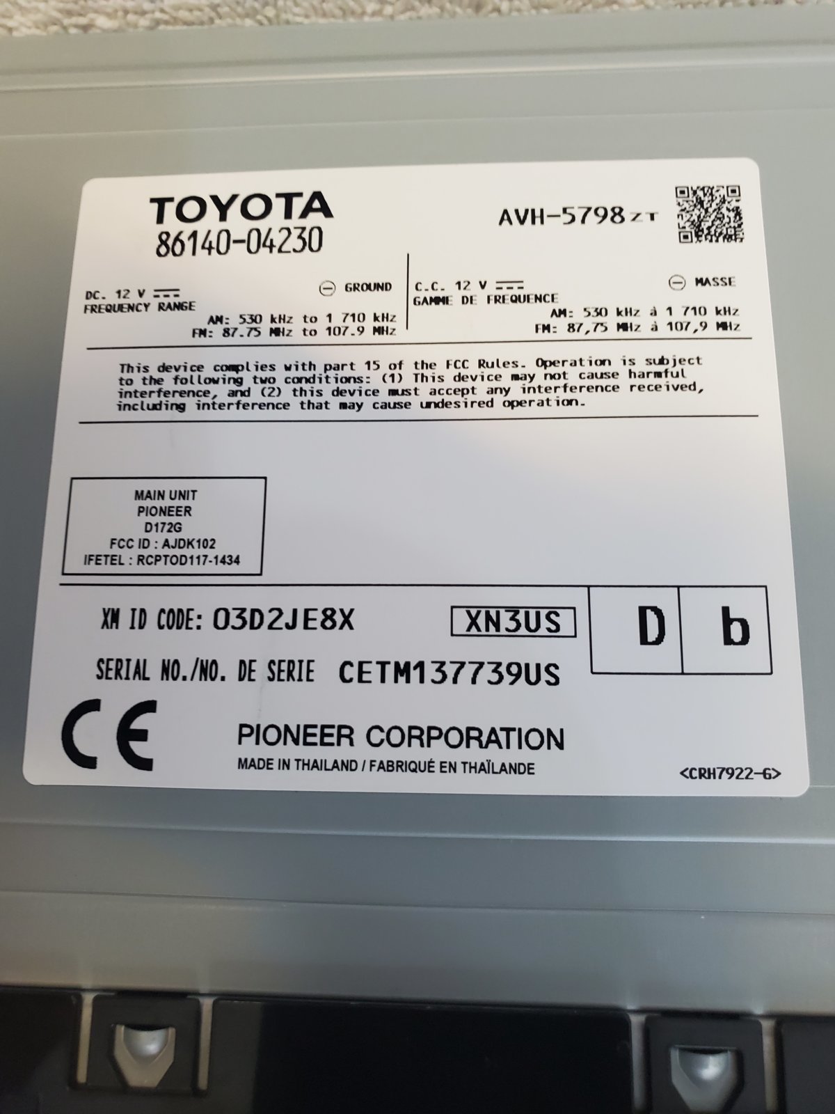

    Hello, I have a 2017 TRD with the JBL head unit, speakers and sub behind the rear seat. I would like to upgrade it primarily to get Apple CarPlay. I saw this 2023 (pictured) head unit with CarPlay for sale and wondering if it will work for me. Will it be an easy plug and play or do I need a new harness, speakers, etc.

    i believe you can only replace it with a jbl-model stereo. that appears to be the standard entune radio, which will not have the digital outputs needed for the jbl system. but i don't know if anyone is going to be able to answer compatibility between model years. no one has performed such an alteration to my knowledge.

    Unfortunately Toyota changed the wiring for the radios starting in 2020 so a newer unit will not plug into an earlier truck. I did read on here where somebody found a company that will make you an adapter to make it work.

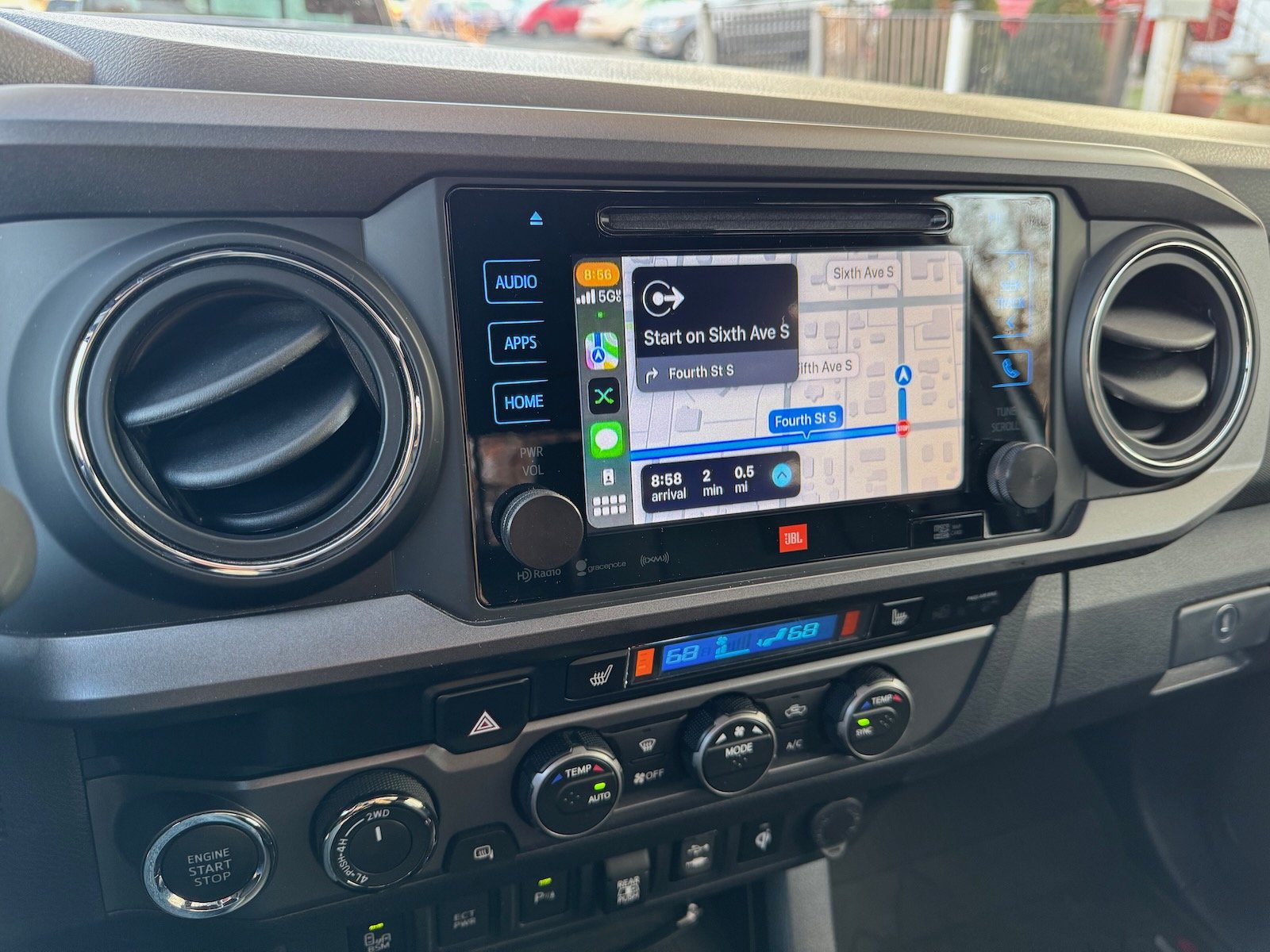

    I have the CARabc one from Amazon, and the res is low but acceptable to me. Works as real CarPlay otherwise:

    I got the AutoABC version and installed last saturday. It's the cheapest version of these at $150. I use android auto. The resolution is a bit poor but that's a screen resolution thing and works through the Aux input. It works as well as can be expected for something grafted onto your headunit. There are some gotchas, since it uses the Aux input, you can't listen to any source than whatever is on your phone. It wasn't immediately clear how to exit this and get back to my original headunit but it's simple enough (pressing the power button or using the steering wheel controls to change source). Audio playback sounds a bit flat or compressed relative to my other inputs. Otherwise it was fairly cheap and works as advertised.
