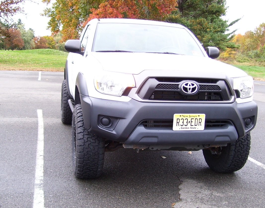

    2013 Tacoma reg cab
    OME 885/nitros, SPC UCA, 305/65/17, AAL
    The 285/75/17 tires are around 33.8 x 11.22 so you would need to go to 305 to get the 12" wide tire. If you're sticking with the 285, 8" or 8.5" would work best. You can go to 9" but it might lead to rubbing. I have 305's on 8.5" wheels with -10 offset (makes them stick out a little more). If you go with 8" wheels you can go with 0 offset (closer to stock) to -12 (would stick out a little less than mine) or -6 which is in between.

    A 17 x 8.5 wheel with 0 offset (4.75" backspacing) is going to be tucked in like a stock wheel but it might be really close to rubbing something on the inside. I think it should work, but you might want to wait until you hear from somebody that has that combination to verify it fits without rubbing. You may want to change the thread title to reflect the 8.5" wheel with 0 bs to see if someone responds. Here's a chart someone posted on here a while ago. I know the 16x8 with 0 offset works with 285/75/16 tires, that's what was on my truck when I first got it (my truck has no front mud flaps, had the flare trimmed a little and has the pinch welds beaten back). Going another .25" in could get the tire close to the upper control arm.
