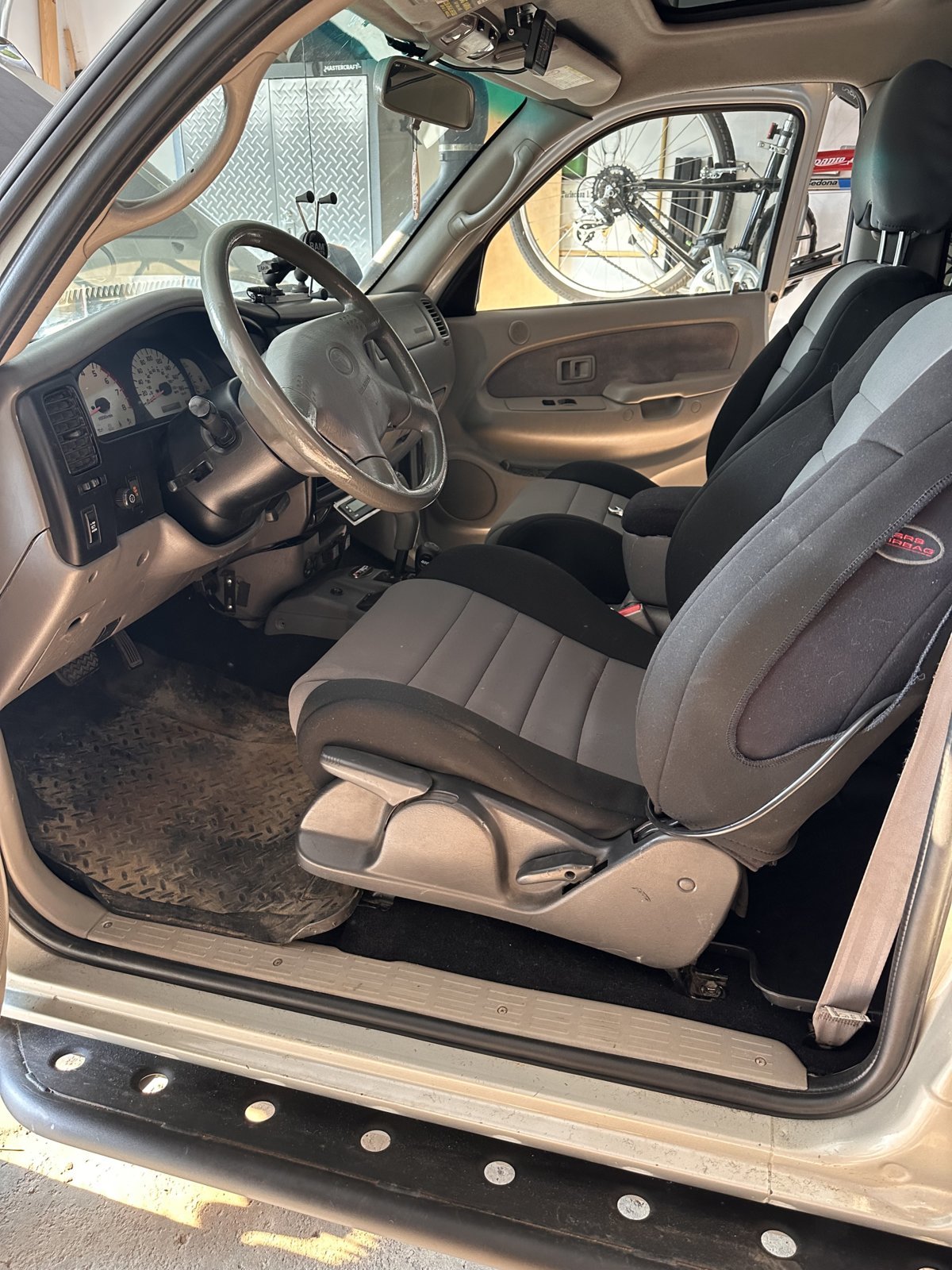

    Hey all. I have a single cab that came stock with the standard bench seat. I replaced that fairly quickly with the standard Tacoma bucket seats and center console. It’s almost 3 years later and now I’m considering changing out the seats again. They’re not totally uncomfortable for me, but I enjoy a good, cushy, supportive seat.
    I’m looking at either the 3rd gen 4runner cloth seats with lumbar, or the upgraded Tacoma seats with what appears to be a power lumbar.
    For those who have swapped to 4runner seats, do you think it’s worth it? I sat in a 4runner while on vacation and it seemed nicer, but I’m not able to compare seats directly. These also appear to have tilting headrests, which are a nice addition. I’ve read that the seat tracks need a little massaging and an adapter to fit, as well as swapping the seat belt buckle, which is fine with me.
    For those with the nicer Tacoma seats, are they noticeably different from the standard seats? Also, I believe there is an unused plug under my driver’s seat, which I assume would hook up to the lumbar feature?
    In summary, I’m looking for opinions on these seats and if anyone can tell me how the power lumbar is connected.

    That plug is for the seat belt switch, just leave it unplugged and you won't get the annoying light.
    I found some Celica seats at a junk yard, bought a set of leather replacement covers, and modified some aftermarket brackets. This ended up being much cheaper than aftermarket replacements, but took a lot of work to make it all fit.
    That being said, the seats I used for my truck were smaller than aftermarket seats, and probably newer Toyota vehicles. I'm 5'9" and 160 pounds and with the seats all the way back in a comfortable position, is almost too small. If you are any bigger than me you might run into some problems.
    Single cab problems.

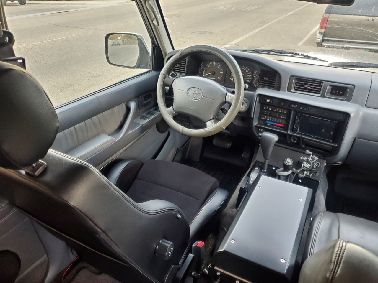

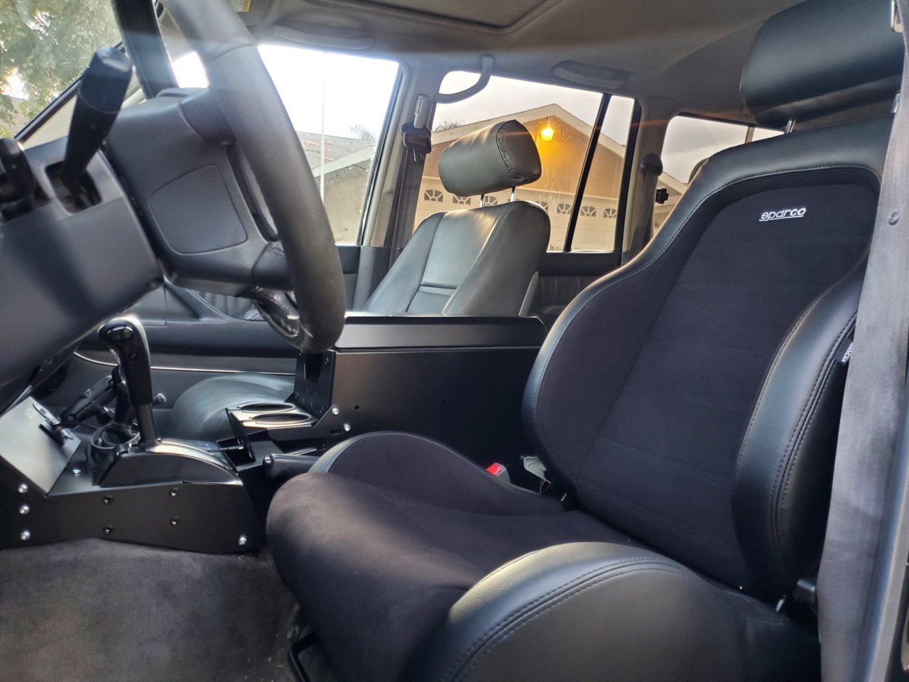

    Kwikvette
    Feb 27, 2019
    #284735
    81,957
    Fresno County
    4 run, 2 don't
    Owned a 1st Gen Taco, hated the seats.
    Owned a 3rd Gen 4R, enjoyed the seats more but not that comfortable.
    Owned an 80 series LC, and the seats were better than both above vehicles.
    Bought an aftermarket seat, made me hate the seats in the above vehicles even more.
    For me, it was the Sparco seat that made the biggest difference.

    What model did you get? Did they sell seat mounts or did have to fabricate your own?

    They sell seat mounts for many vehicles, but fabricating your own would be easy too.
