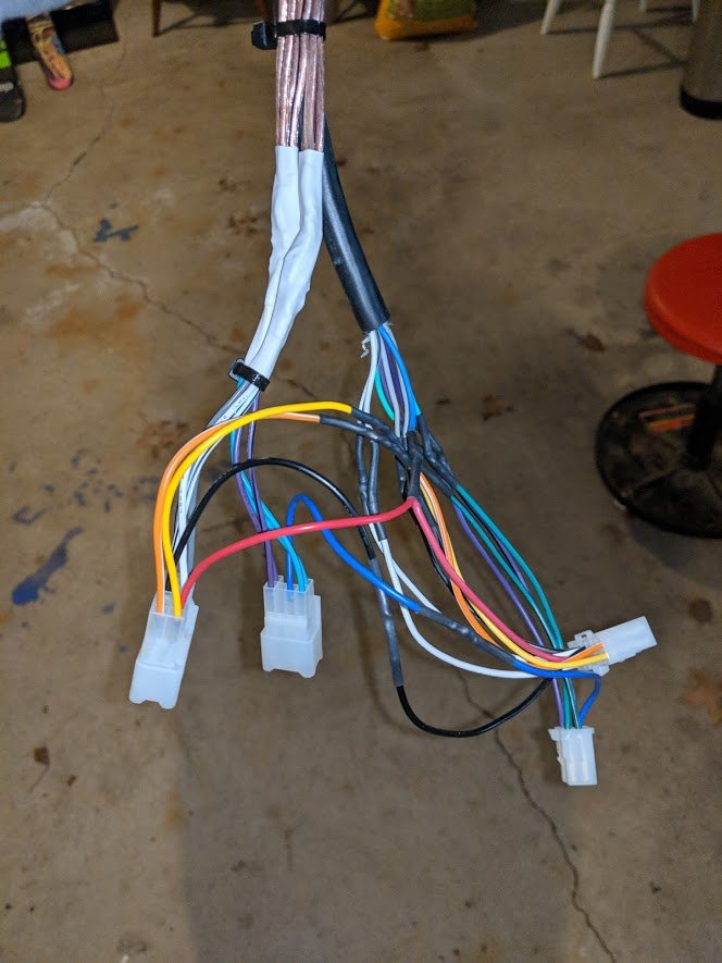

    First: Are you running the stock head unit? If so, there are no RCA outputs from the stock head unit, and you will need speedwire to go from the head unit to the line level inputs of the amp.
    Second: You will need toyota wiring harnesses to solder to said speedwire going from the head unit to the amp. This is how mine came out, but I used the OEM wiring throughout the truck, so I have speed wire from the head unit, and speaker wire going back to the harness for the speakers:
    If you are not using the trucks existing wiring (which you can up to 85w RMS), then you just need to go from the head unit with one set of speed wire, and then from the amp direct to the speakers.

    No, it is aftermarket, and i'm going to be running 100w RMS. As of right now, I have one set of RCA cables ran from the amp to the HU as well as the remote wire. My plan was to just run wires directly from the amp to each of the four speakers. Will this not work? I know it will be a pain going through the door gromets but in the end I think it'll be the best way to do it.
    Do the RCA and speedwire hookups accomplish the same thing? Sorry if i'm over complicating this, I just want to avoid taking out the HU again if possible.
