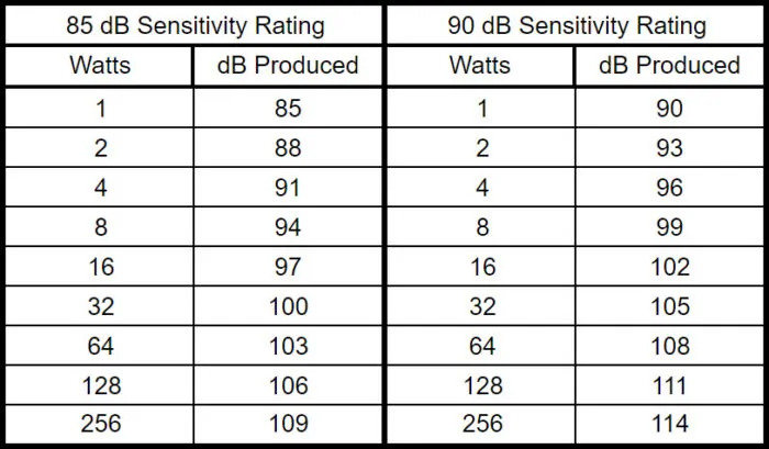

    Let's do the math since I know how much everyone around here enjoys my math...
    Because dB works on a logarithmic scale rather than linear, you can't expect that a few more watts will do a whole lot, especially once you get past the first two Watts. Let's look at this chart real quick like:
    You see the majority of volume comes from the first Watt, then every time you DOUBLE the power, you gain 3dB. I'm here to tell you that 3dB ain't a shitload. The speakers chosen for this experiment show 92dB sensitivity. I don't know if that was measured at 1W 1M (probably not) or at 2.83V but it doesn't matter for the purpose of this explanation right? Let's call it 1W at 1M.
    1W = 92dB
    2W = 95dB
    4W = 98dB
    8W = 101dB
    16W = 104dB
    32W = 107dB
    64W = 110dB
    128W = 113dB
    WHAT? Less than a 3dB gain? Sacrifice L/R balance and any modicum of stereo imaging for that? Let's give up all the extra speaker damping the amp provides at 4 Ohms because we want a fraction more volume? MORE IS GOOD RIGHT GUYS? I mean screw that guy that mixed the album, he didn't spend hours placing sounds all around that recording for your enjoyment or anything, it's cool.
    No.

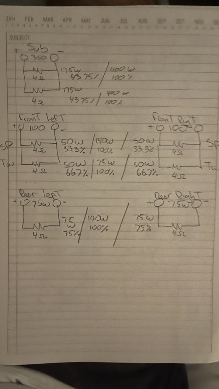

    Man. I want to thank you for this comment. I was totally ignoring for a sec the balance factor. Like I said if I am missing something let me know. Thanks for letting me know. I am changing the way I am wiring like to the one below since it is too late for me change the plan significantly.
    I will wire the front left speaker and tweeter and front right speaker and tweeter in parallel the same way the factory system comes. That way I don’t lose balance in the front. The front will have to be at the ohms.
    the rear speakers will be at 4 ohms on their own channel.
    This way I don’t lose balance or fader. this is the first time I am changing from a 3 way speaker to a new way+ tweeters so that got me confused on how I would wire to a 4 ch speaker.
    The bass I will keep the 2 at 2ohm is I can fit them because two moving air at 175W is better than one moving air at 350. I won’t be blowing up the 10s and they will work cooler. That is the whole reason. Not necessarily “louder is better”.
    the cap I might not install it and see how the system goes without it. If it is all fine I will just return it since it is unopened and save 45bucks lol.

    I also like doing some math. This is the new wiring diagram with the changes. It looks like I overshot the front speakers since they will win at 33% top but getting the same speaker with lower wattage would have save me 20 bucks so I am not mad about it .
    I could have also picked lower on watt bass but also room to grow the was in my mind. The base would run at 43% each top. Better than having them running at 87%.
