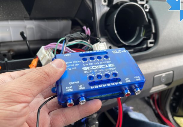

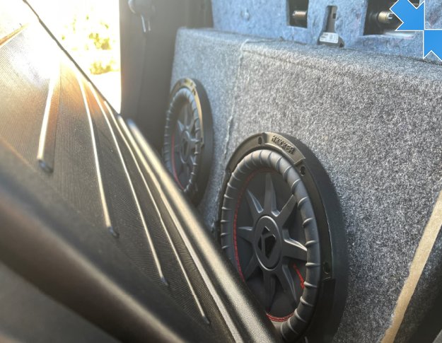

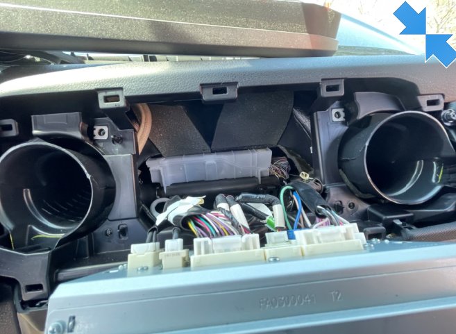

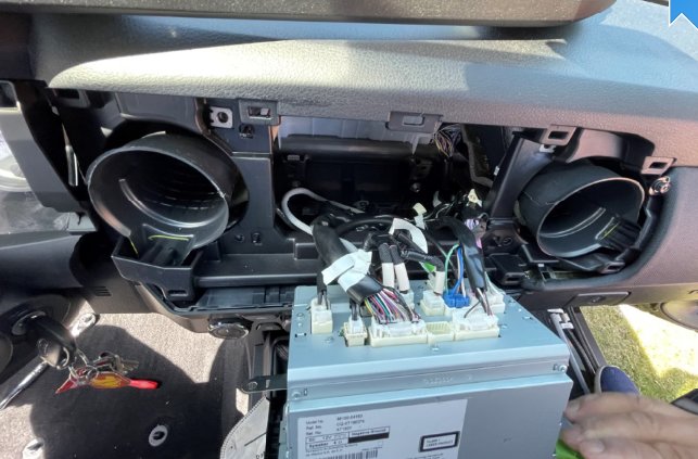

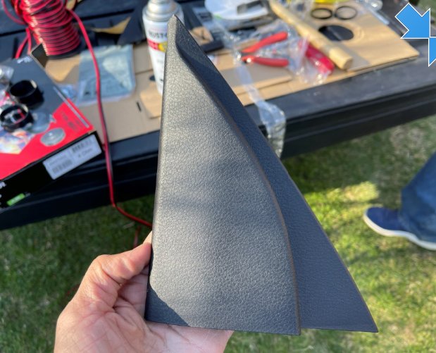

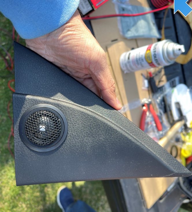

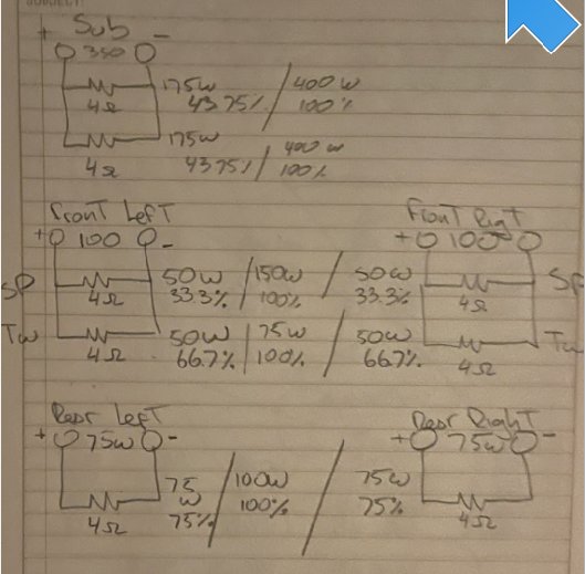

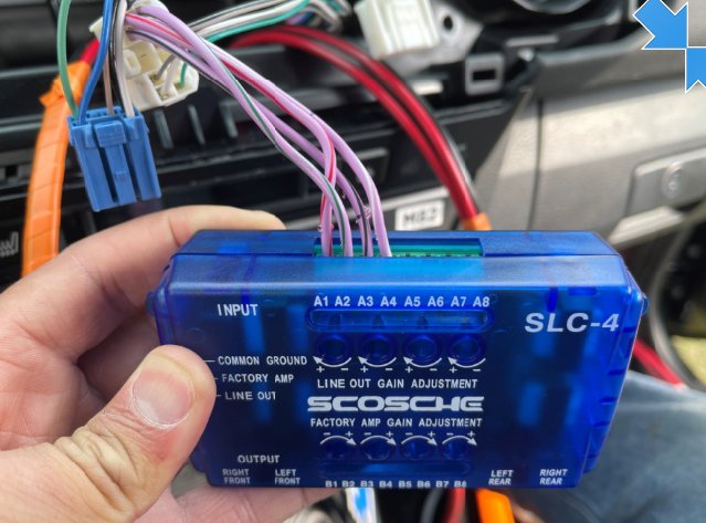

    Here Are some pictures I took during the whole installation:
