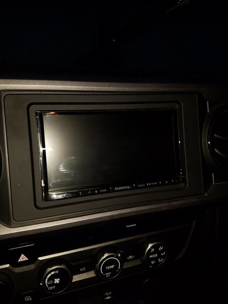

    Do you have any pictures of the headunit installed? I am interested in an aftermarket head unit but want to maintain the factory look. Does the new head unit work with the back up camera and the steering wheel controls? Thank you

    Back up camera works and you still have the factory guide lines displayed on screen.
    Steering wheel functions are kept through the idatalink maestro adapter.
    The only thing you loose on your in MDI is anything Nav related. You can still view everything else you could and get vehicle info.
    The Kenwood has a tire pressure gauge on it as well as a screen with different gauges on it but.
    Now while this head unit doesn't have Nav, it does have Google maps through android auto. You don't even have to push any buttons to utilize " ok google" just say it and you can use any features your phone offers through ok Google
