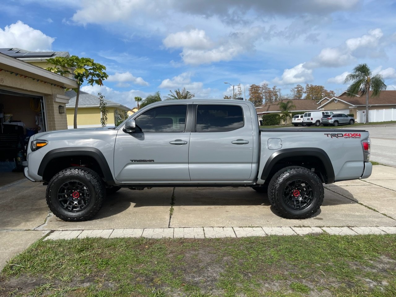

    Looks sweet

    My dude that is a sick rig. I thought I was happy with my stock billys till I saw this... my wallet hates this forum.

    Yeah the forum is definitely a wallet killer
