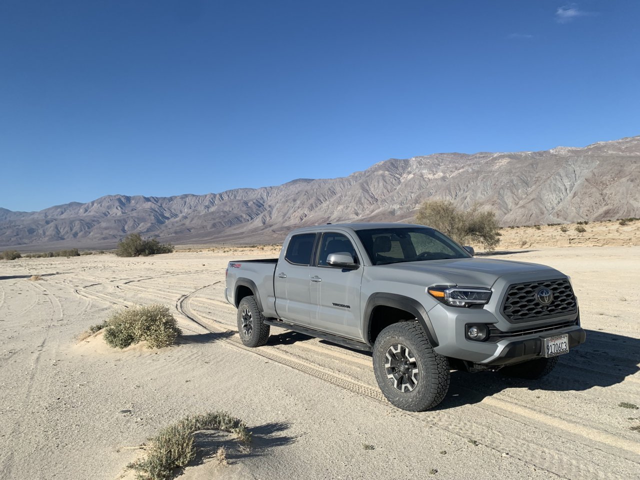

    I went with the Bilstein 6112/5160 and it made a big difference from the stock off-road suspension. I was surprised how much better it is. When I go fast on the desert trails it eats up the bumps way better. I haven’t tried other suspensions, so not sure how it compares to those.

    I did 1.5” lift / AAL/ UCA and switched to Falken Wildpeaks 265/75r16. I’m new to off-roading and this was a good first step for me. I use this as my daily driver as well.
