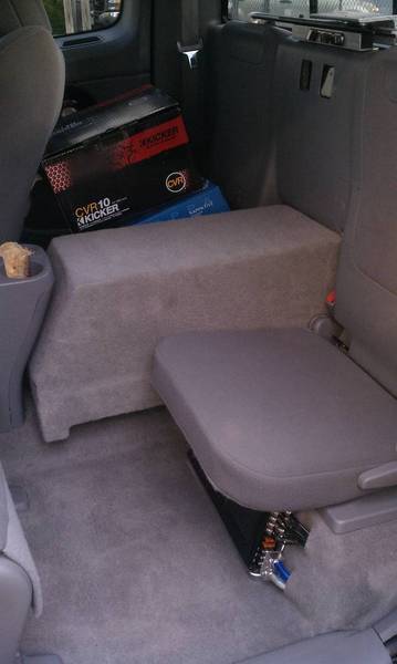

    Kenwood HU,Infinity Kappa speakers (x4), Infinity reference tweeters(x2),10" Kicker sub, Box by Subthump, Infinty Five channel amp,DVD anytime bypass, DTRL Mod, Xtang trifecta, Fogs anytime Mod, Bed Mat,Westin running boards, Console vault, Maglite mod, Weathertechs,Autopage remote starter, Power tailgate lock, HID Bi Zenon, Hella Supertones,Rain guards,Rear leaf TSB,Steering shaft TSB, Fisher Homesteader plow, 886 reverse lights mod, Redline Hood struts, Hankook Dynapro ATM LT265/70R17, power sliding rear window, Auto dimming/on anytime Bed lights, Blue Sea fuse panel & 100amp Breaker, de- badged,Rear headrest's removed, imMrYo mirror relocation,Homeroshi grill
    I went with this set up and I really am happy with it. 10" Kicker and a sealed subthump box

    Nice setup, and I plan to do something similar in my AC, but the OP has a DC, and will be putting his sub behind the back seat. I would search Mr Marv on this site just to check out his boxes to get an idea of what is typically used. He builds some nice stuff, and has been doing it for a long time. With the right 10", you can get it to go low enough and loud enough for your musical tastes.
