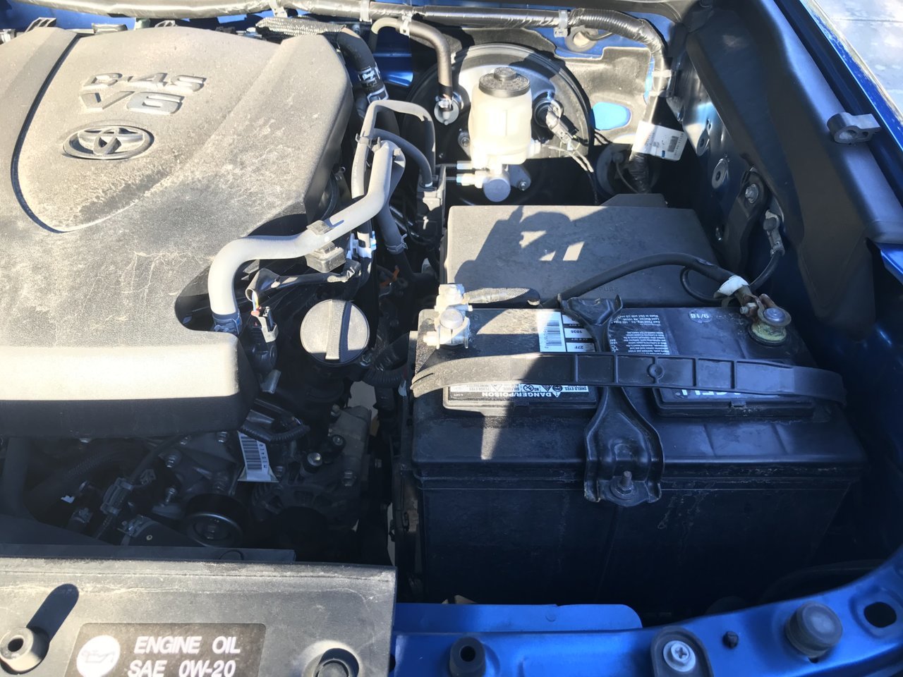

    The 27F fits in the 24F tray (I think they’re the same size). In the 2016...
    ...the 27F fits exactly within the tray and doesn’t interfere with anything.

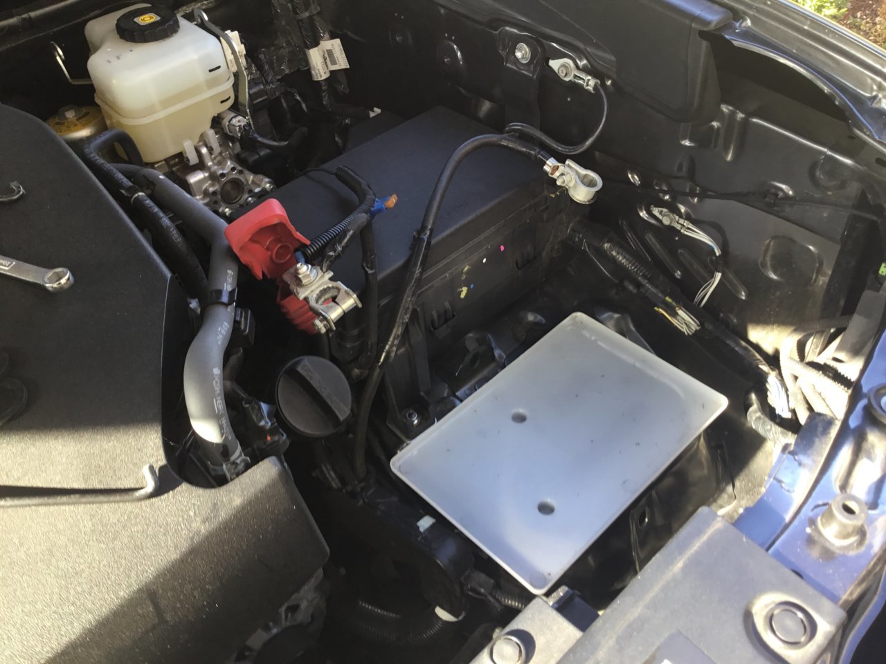

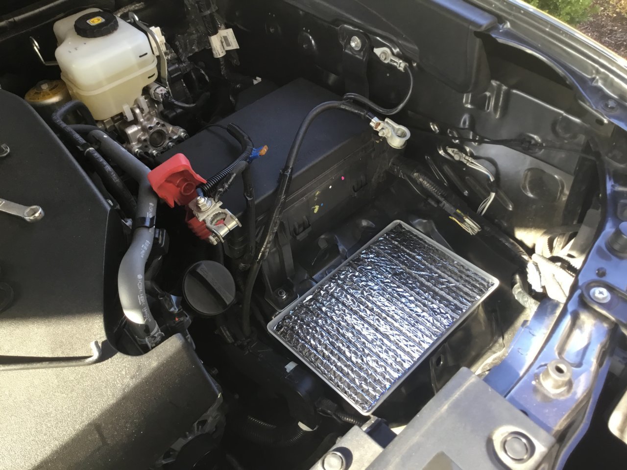

    Or put a 1/4” hard rubber mat or other material in the old tray so the larger battery sits slightly higher without the need for trimming the tray.
    I placed some insulation in the tray to keep the bottom of my new battery warmer in the winter, and to maybe reject a little heat in the summer.022584EB-A8D0-46E1-8EF6-5F5E70820DB4.jpg 07549F02-A7D1-4631-9774-3540684A11A5.jpg08F21D95-1B9A-47E5-A245-CE9D9F4DDAF1.jpg2814F4BD-7B30-42CE-AC58-E04CE96FC731.jpg
