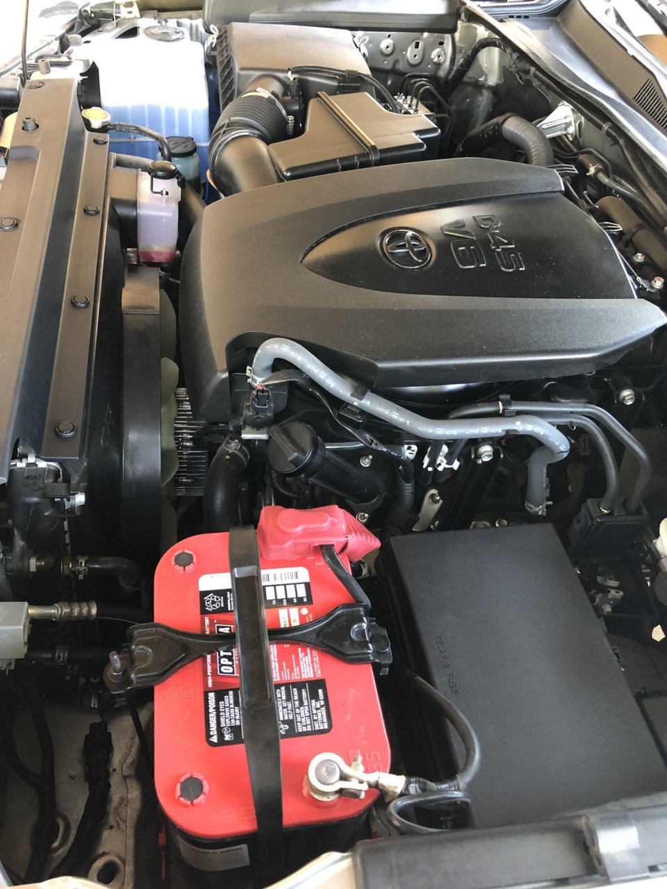

    Picture of the battery of my son’s 2020 OR

    So no changes here.
    Same exact battery and PN as my now spare '18.

    Thank you for the picture, and confirming the 2020 models have the same battery 24F as the older third gen Tacomas.. Much appreciate it..:thumbsup:
